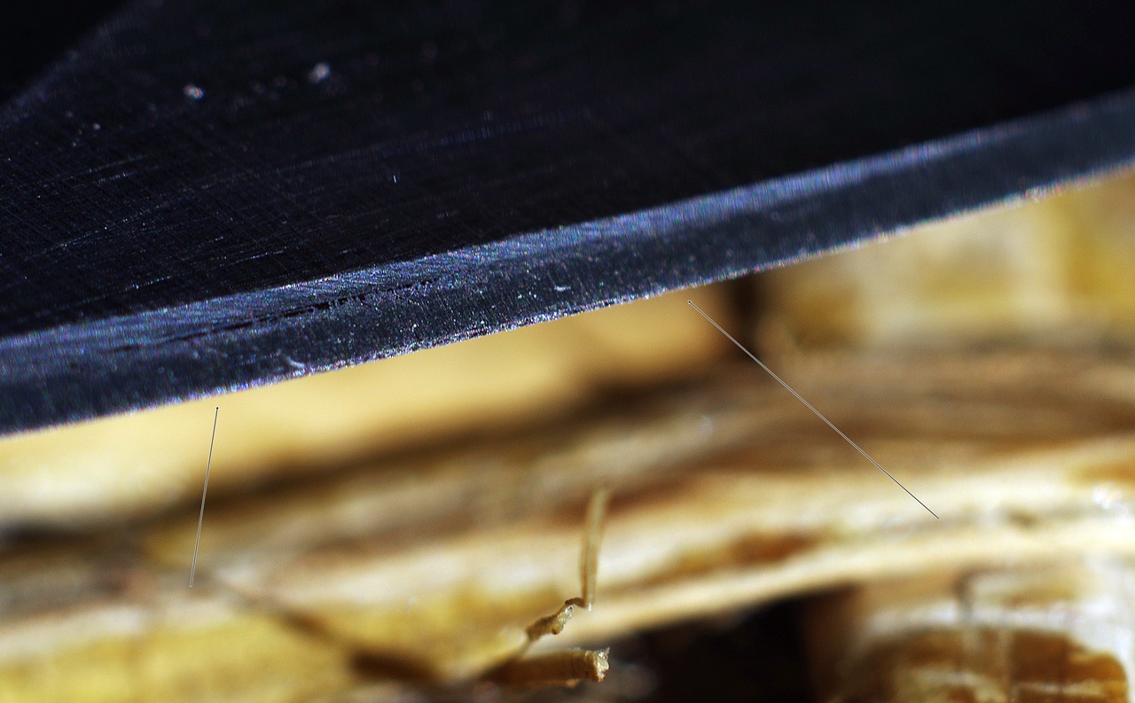

60 grit ...
I did quite a bit of FUBAR removal ..
The wetstone grinder shows up things like this ^
Pictured is a dip or hollow in the edge .. This comes about because some one lingered too long in one spot whilst forming the bevel .
I got rid of bout 99.8% of this FUBAR .. There is just a small amount left , and it should not affect the next slice test !
The wet stone grinder removes / eliminates mistakes like this with a nice straight bevel .. ( Got to like that ) .. It also shows up bad grinds , which can be disappointing to find !
