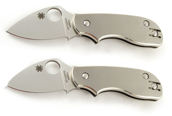

So, my idea...What if I was to round off the tip of the knife, give it a kind of a sheepsfoot end, and resulting in a really friendly, stubby, one handed opening, cute little, sharp as hell, every day carry.
Is this doable/advisable? If so, how cheaply could one achieve decent results. I'm imagining a grinder of some sort would be ideal but, say, if i was patient with a vice and a metal file then some wet-dry paper for finishing, could i get there?
Below is a quicky photoshop of the sort of thing I mean. Above is stock, below is what i envision. Just a "softening" of the tip.
Let me know what you think. Also hello. First post :)
Can't see why not, I used some files to round the tip on a Shrade I have that was all messed up.
Just go buy some wet/dry sand paper in 800, 1200 and 200 grit and drag your knife spine along it while rocking from spydiehole to the tip getting steeper towards the tip.
Easy to do, and you won't have deep gouges like a file would leave you with.
Unless you have a belt sander or high quality single cut file designed for metal, the above method is what I would do

I accidentally rounded the tip of my Dragonfly II while sharpening it on a Sharpmaker, therefore, it is possible and not very difficult...
I like to reshape blades to suit the picture in my head of what they SHOULD look like. For what you are going to do, a grinder is overkill. A belt sander and a light touch would be ideal, as long as you keep the blade fairly cool with a squirt bottle or dip it in water. Tape the blade up to protect it from scratches from the cutting tool you choose, or from your clamps or vise.
I had a Benchmade Griptillian with the tip missing (1/8 in.). I dressed it without any problems just using a file and stone. If I can do it so can you.

A bit of file work and sandpaper should take care of that mod for you. Just work slow and think about what you're doing... Remember, you can't put material back on once you take it off (I'm often guilty of doing things a little too quickly).
