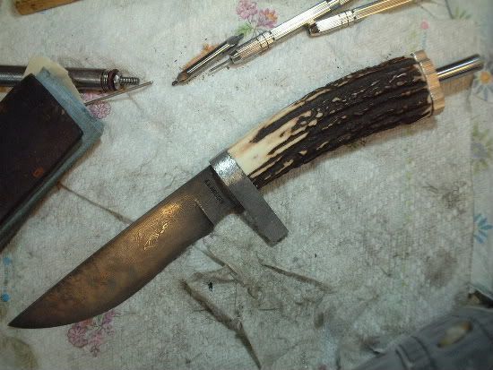

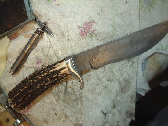

I'm trying to finally finish up a hidden-tang forged blade that's been haunting and taunting me for a LOOONG time, and I can't seem to figure out a good way to round or radius the finger side of the guard. I've tried slack belting on the grinder and shoe-shining by hand with 180x shop roll, but neither of those methods seem to be working very well, so I figure I'm going about it the wrong way. Is there a technique for this seemingly simple step that anyone can share?
Thanks for any tips!
I assume that's how you shape the guard, Patrice? I've got it shaped about where I want it, but I can't figure out how to make the finger-side surface rounded/radiused/convex in shape. Not sure if my question even makes sense?
You're wanting to form a convex surface on a concave curve -- the round and half round files are how to form that.

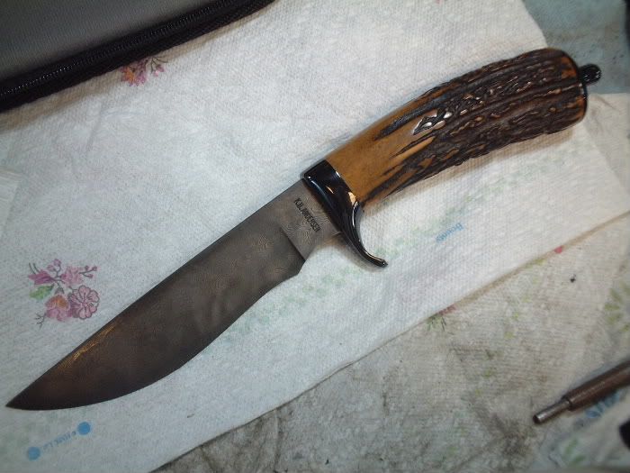

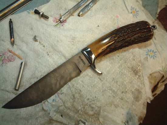

The 6th photo in this post from the Epic Wheeler's Steel thread shows the rounded or radiused finger-side surface of the guard I'm asking about (the polished area in the photo.) http://www.bladeforums.com/forums/s...he-Adventure-Continues!?p=9597145#post9597145
When I rough shaped the guard using a file or dremel or small wheel, the inside of the resulting concave surface was flat, not radiused like what is shown in the photo above. Shoe-shining or slack belting seems like the right idea, but it cuts the wood too fast (and the guard not fast enough.)

I do the rough shaping with a sanding drum and continue with files and paper wrapped around dowels, etc like the other guys said, to blend the flat "facets" left by the drum into a smooth curvy surface. Don't over-think it :)

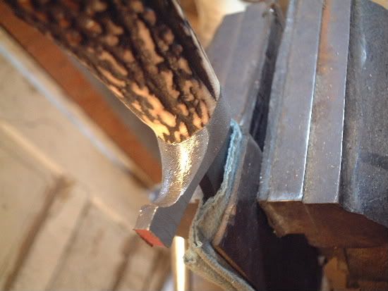

Rather than filing straight back and forth, once you have your basic shape, you have to use your round or 1/2 round file to round out the corners in the front of the guard. Start by knocking the edges off of either side of the flat curve you've created, and then gradually facet the guard to rough-in your radius. Then smooth it up by rocking the file over the radius as you move it, moving to sand paper later on.

To be clear, are you talking about radiused perpendicular to the blade as in a cross sectional view, not parallel to the blade like a side view? If so, just run your half round files over the edges to round it out.

Xander, I'm not sure I'm following your question, but I think I understand your solution anyways and seems to fit what everyone has recommended. I'll try it.
Paul, I've run into similar issues myself - polishing the guard / handle juncture with slack sandpaper can create a dip as the handle material is removed much more quickly than the guard material. To remedy this situation I typically use dowels, but I've also made special sanding blocks out of micarta for this very operation. I simply grind the block to shape so that it matches the interior profile of the guard / handle junction. I've found this to work quite well, and I've reused the block on several knives by simply re-profiling it slightly to meet the dimensions of each knife I've used it on.

I do the bulk of the work on guards with a small half-round file. Then I chuck up a short piece of round rod in a hand held drill and tape sandpaper to it. I use progressively finer grits of paper with the drill set up to about 400 grit, then dowels and sandpaper to finish.

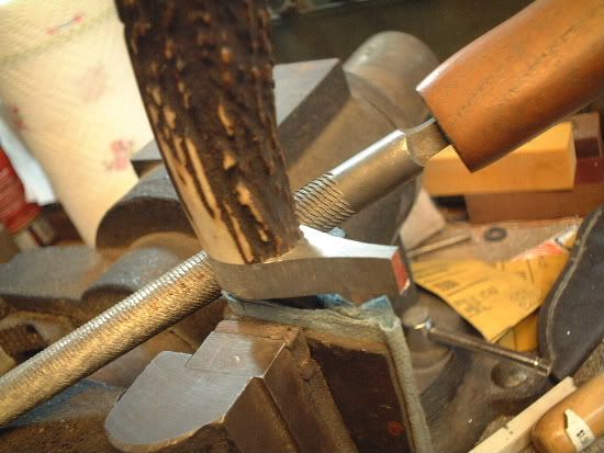

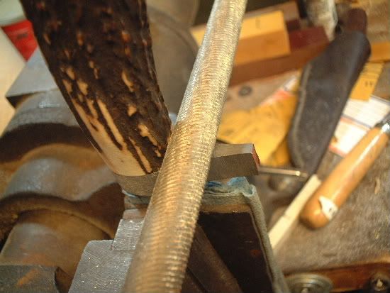

This is going back a few years, but here's how I accomplished it more than a few times:
Thanks for the tips, and the pics are especially great since I often need them to help visualize what is being described!
