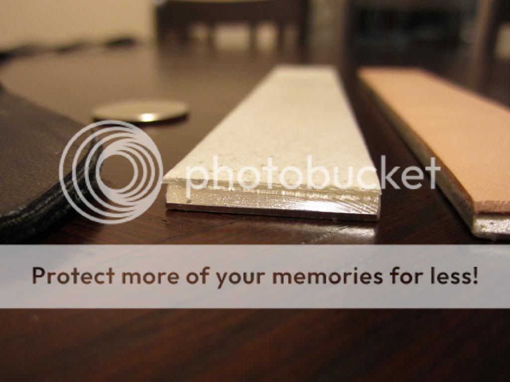

I thought at first that some of the slop that exists when mounting these strops in the pivot arm could be the culprit, because these strops are not on a typical blank like the blanks for the tapes where 2 aluminum plates are bonded together. The nano strops are one single piece of aluminum with the nano bonded on one side so it can be tricky getting them to tighten properly in the pivot arm. They would go in and out of the arm much easier IMO if the nano was mounted on a typical tape blank. However, I checked the angles and they were in fact spot on.

Nanocloth has virtually no give at all# It just wont deform its too thin , and the bare cloth alone has zero affect on an edge#
