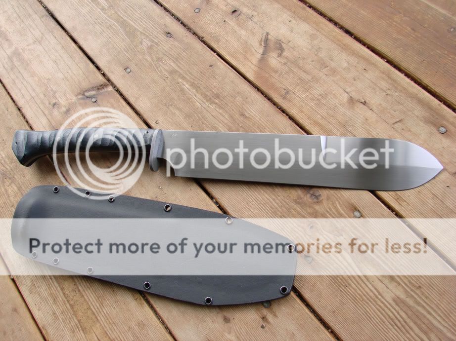

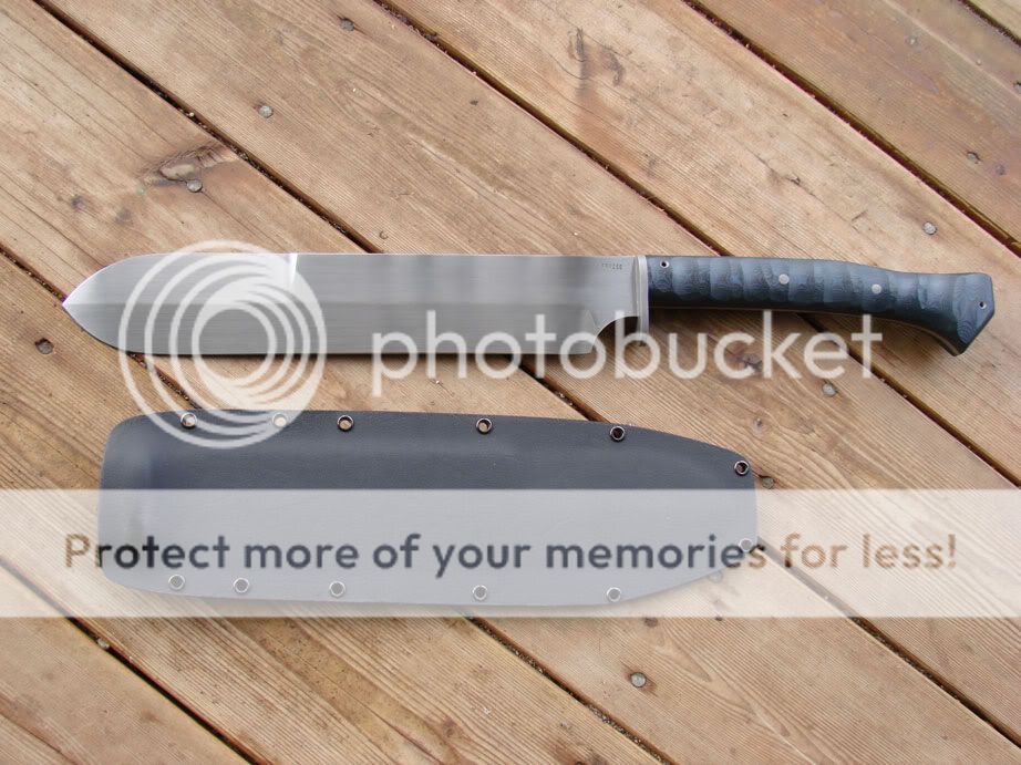

Here is the backup to the order that I did for a customer.
Almost 24" overall and with a little over 13" blade length.

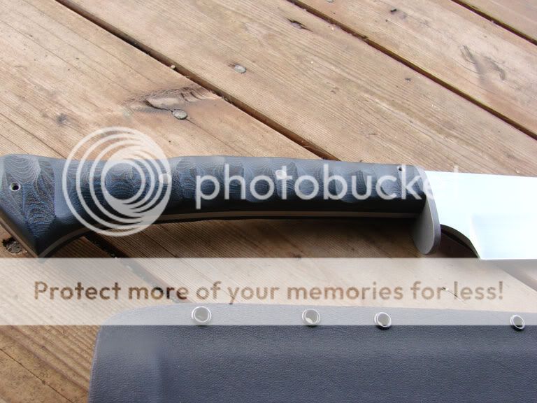

Steel- .200 thick 52100 heat treated to 60-61 Rc by Peters Heat treat. Handles- Blue/black G10 with grooves/texture.
Fixtures- Bead blasted 416 guard and ss bolt and tubing.
Marked RR and #2 on the right and with Frazee on the left. Flies through paper and has a nice toothy edge. Enough talk- here it is
Dan
I really love the design of this chopper, very well made man.
I was wondering why you lighten the point. Isn't better to have some more weight in point rather than lightening?
Just asking.
I have one of Daniel's Cutters and his work is first rate! I love this one as well.
Pattern looks great and excellent choice of steel!
