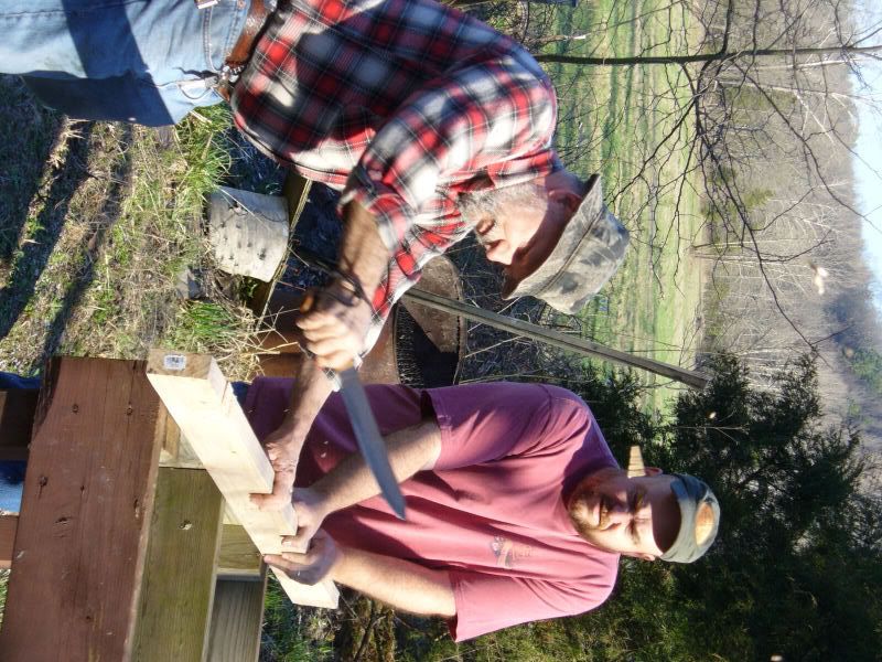

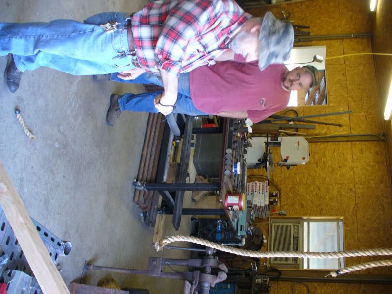

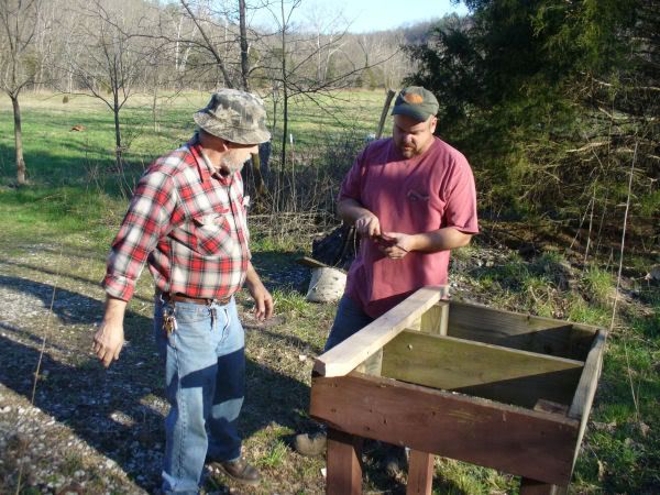

I was priviledged to get to witness Russ take his MS performance test at Sunfish Forge yesterday. Observed and administered by Don Hanson MS, Russ went through the performance steps in quick fashion with a finely-tuned knife. I will be brief and let Don and Russ fill in where they would like. This thread will be the cutting photos, then I'll follow with the bend test.

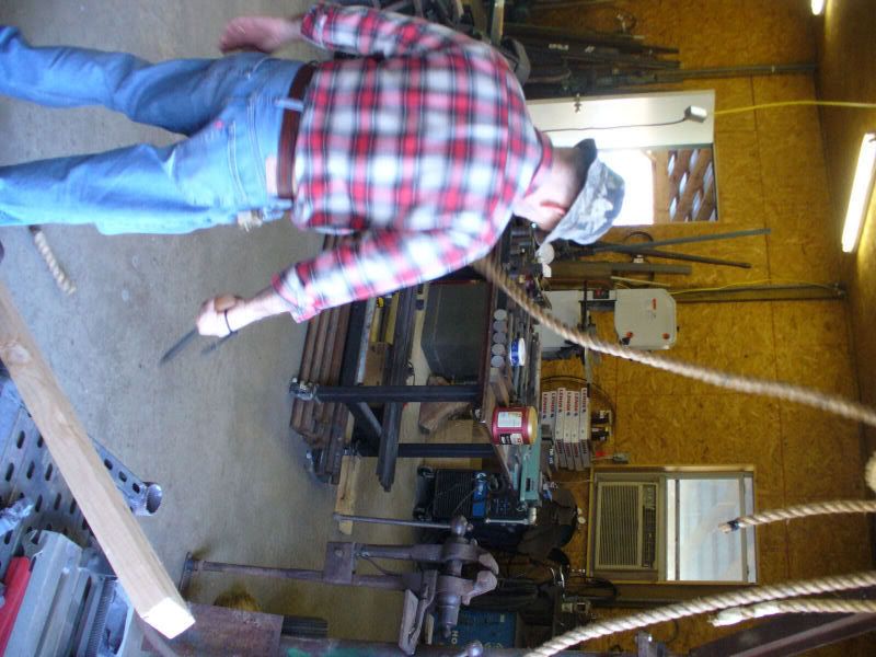

Russ' 352-layered 1084/15N20 test blade was so sharp, and Russ was so quick, I missed the actual cut of the rope:
Humm, that edge geometry is pretty good!

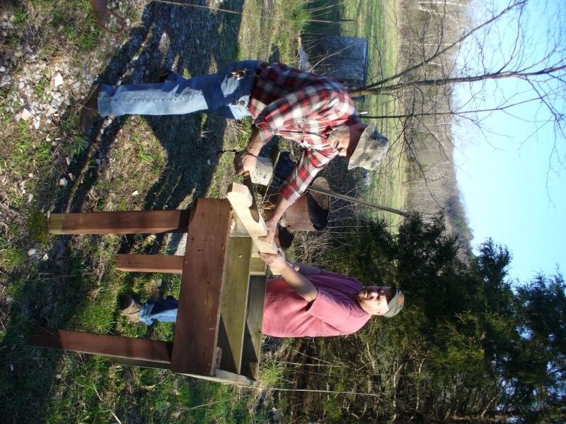

Outside for the 2 X 4 chopping:
Russ made the knife talk, the toughness showed:

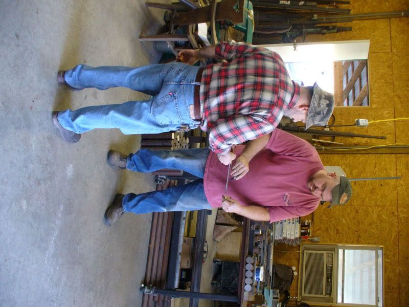

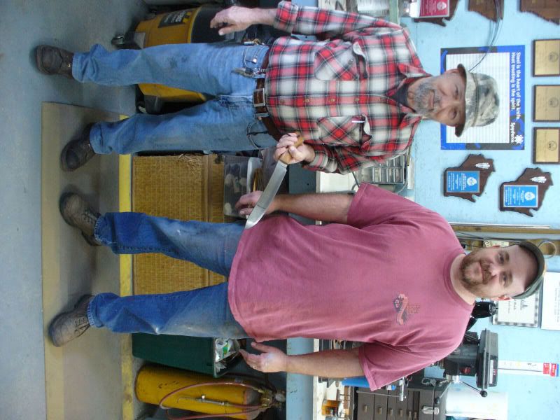

Don checking edge retention, while Russ was telling him to be careful, that blade is hot!:
Russ shaved off what seemed like a handful of arm hair next.

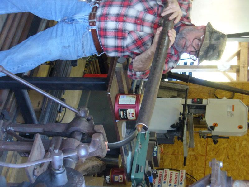

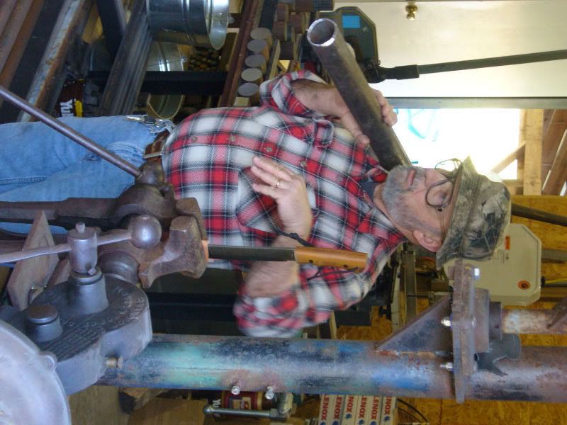

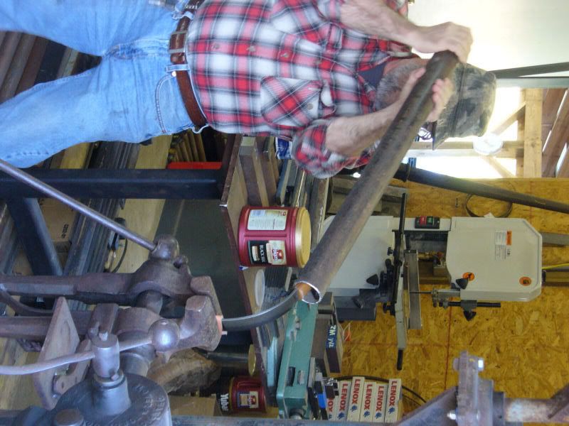

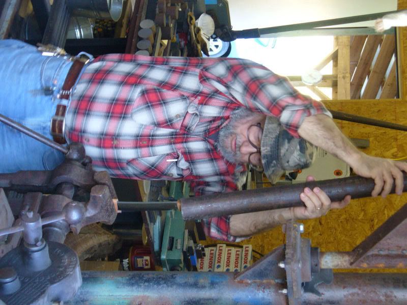

Back inside, we have Don measuring the blade to test for the 90-degree bend part of Russ' MS performance test. 1/3rd from the tip of the blade:
Russ explaining his preparation for this critical part of the test, heat treatment of the blade:
I'll let the pictures talk here:
Russ' knife performed admirably!
And, after all the dust, smoke and chips settled:

I think Don's right about FT/NT question.....A narrow
tang is more difficult.....it's also more appropriate,
since most forged blades (especially damascus) are
narrow tang construction.
Pic of bent knife attatched...
