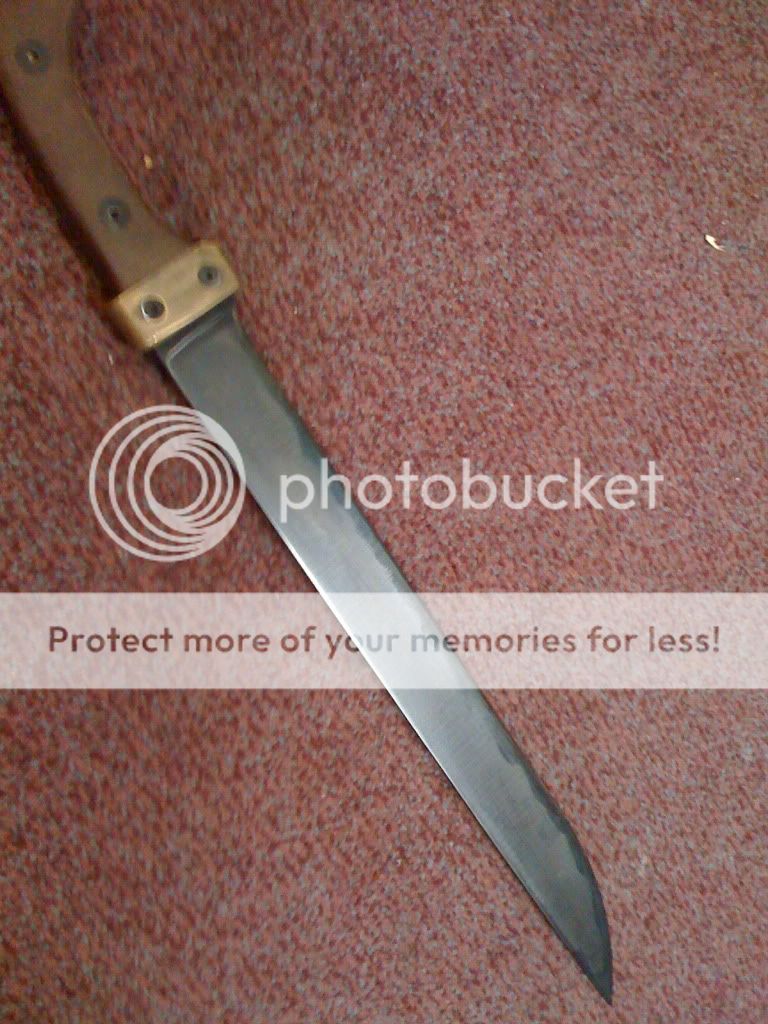

I've been getting ready for my annual April camping trip (all are welcome) and deciding on which blades will accompany me this time around. I'd like to bring a nice big chopper and I think I've decided on my MMHW DV8 instead of buying a cheap machete. My problem is that there is still a LOT of snow on the ground up here in April and my cutting implements tend to get wet pretty regularly. The DV8 is made of some high-carbon steel and rusts very quickly, even with just a tiny amount of moisture. I was wondering if you guys have any tricks to keeping your high carbon knives from rusting. I could bring some gun oil or similar with me but I'd like to avoid that if possible. Maybe a multi-purpose oil? I thought maybe olive oil or just wiping the blade down with my lamp oil-soaked dryer lint might do the trick. I did treat the blade with some gun blue today but I'm sure that won't do much to help with the rust.
The freshly-blued DV8:
The 'temper' line is fake. I just let the acid sit there longer, thought it would look neat. The blade is actually quite a bit darker than in the pics. :D
