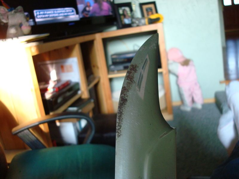

Hello fellow knife enthusiasts, i need some advice on how to remove rust from a hunting knife i won on ebay. the seller didn't mention anything about rust and i didn't think to ask. i am pleased with knife the blade still has the factory edge and the overall condition is excellent but i have to remove the little bit of rust along the cutting edge. can someone tell me what would be the best way to do that? is there a way i can restore the mirror finish myself? i can post pics if nessessary. thanks in advance, andy r.

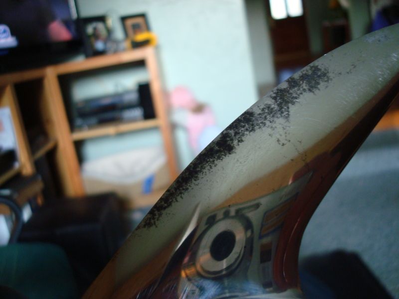

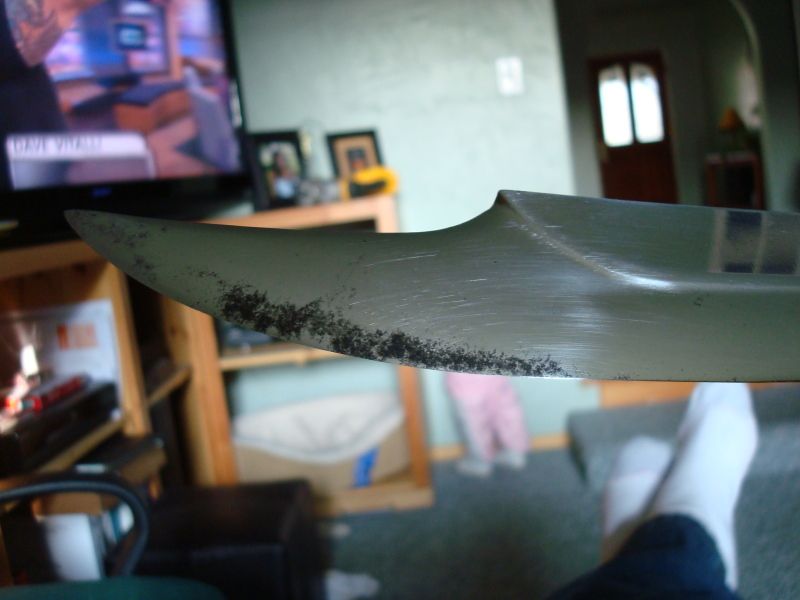

thanks for the replies, i took some pics so you can see what i'm talking about.
That's not a job to do at home. You can scrub it with 0000 steel wool to remove the surface rust. If there is pitting, and I suspect there is, it will have to be ground out and re-polished. Some of those German knives were chrome plated. If that is the case then the steel wool scrub is about all you can do.
Most of that looks more like patina and/or pitting left from previous rusting. The 'red' rust is what should be removed ASAP, if it's there. Polishing paste (Flitz/Simichrome) can do that, or scrubbing with WD-40 should also work. The 'black oxide' (patina) won't harm the steel, so it's up to you if you want to remove that or not. If there is pitting, the blade will need sanding/grinding to get rid of that. If the blade is chrome-plated, sanding or grinding will remove that, and expose the raw carbon steel underneath to more oxidation. If the knife is intended as a user, that might not be a big deal. If you're wanting to preserve the original look of the blade, then sanding may not be the best option.
