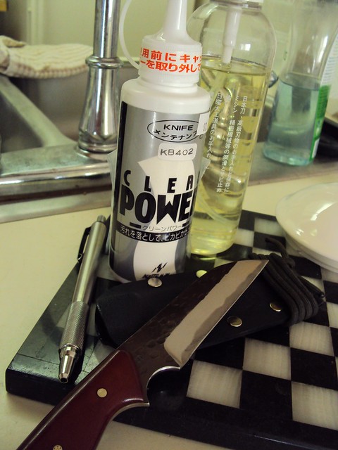

What you should do for next time is go to your local chef shop, they should have something called Clean Power, it comes from Japan and it's used specifically for carbon steel knives. I had a lot of rust on my Carter from an ice tea spill, just two applications of the clay like liquid and rubbing it in with a paper towel and the rust was gone. It'll take your edge and remove the patina (if you have one on your knife) but also the rust as well.
