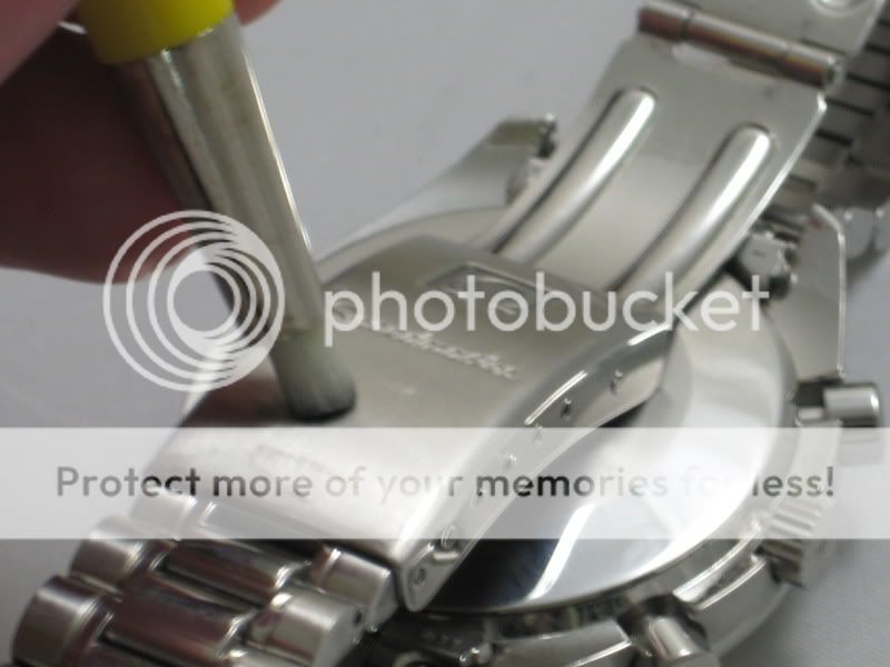

But anyways, it developed some rust on it a few days ago and I took a fiberglass scratch brush to it in order to remove it (which worked amazingly, btw).
I was just wondering, aside from regular oiling, is there any after care I need to give this newly scratched blade? Or is the surface steel the same as the newly exposed steel?
(Scratch Brush)

That fiberglass scratch brush looks interesting; I'll have to look into that. :thumbup:
