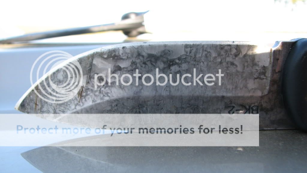

Okay I've been using mineral oil for a long time on my blades ,first and foremost because its natural/eatable. Now I know its not the end all be all but it works, but apparently only under ideal conditions. This is the second time I've had an issue, the first time was on an HI Khukuri that was stored in its leather sheath displayed in my house, I attributed the sheath as well as oil residue from limbs I cut down to that problem. This time however its on my BK2 that was stored in a kydex sheath that's been residing in my truck for about 6 weeks or so.
I wiped it down generously with Mineral oil before storage but still have rust creeping through. I wouldn't think this a factor because of the kydex allowing moisture to release. I have machetes I keep in the garage and normally those will get some good old A1 and they seem OK but they live their life in the garage which is modestly climate controlled.
In a vehicle its a different story (apparently) the temperatures get extreme inside a closed vehicle. This is the first time I've carried a dedicated blade in my vehicle, does anyone else have such issues?? if not what do you use to protect it??
here you see a couple streaks by the tip

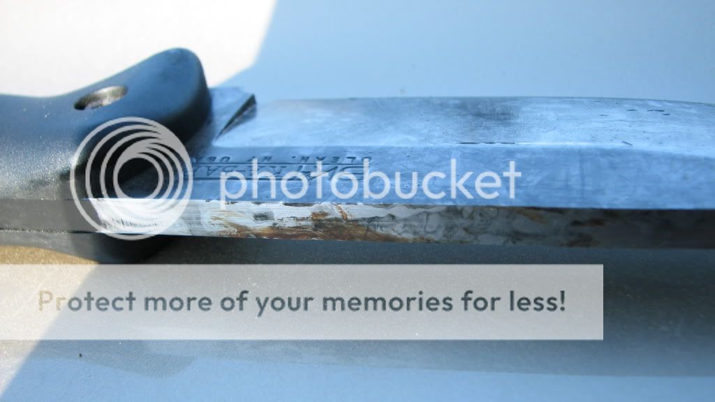

there is a streak where the grind meets the stock, hard to see but its there

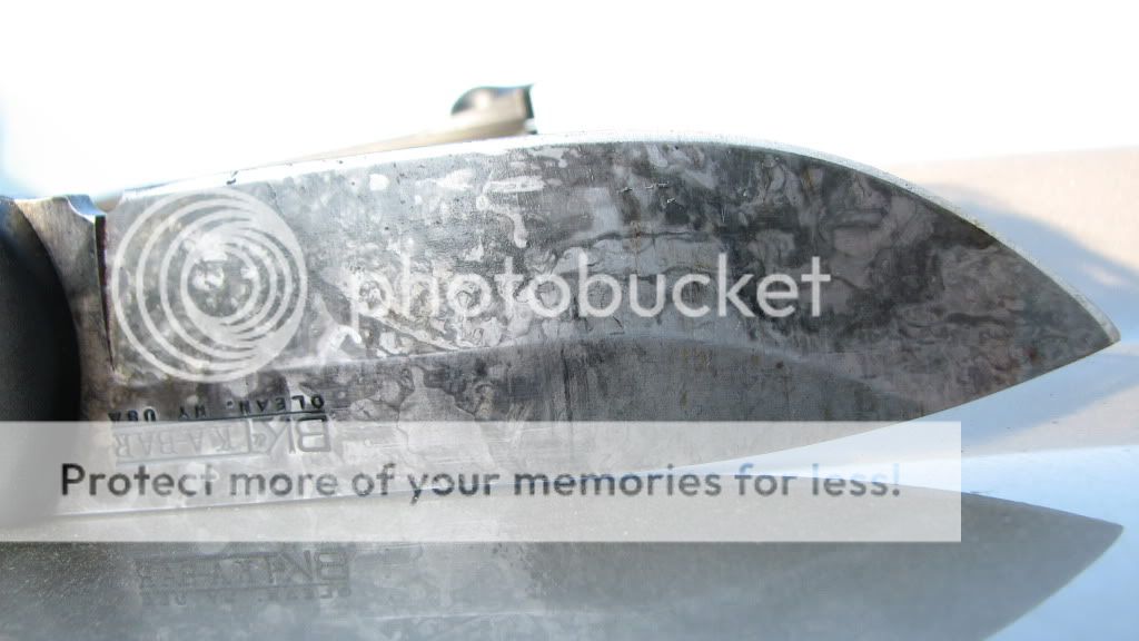

this one needs no description :D
Very possible I missed a few areas?
