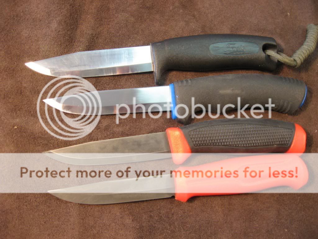

I like a forced patina too. I wish I had a shot of my O1 EnZo which came out really nice, but all I have available right now is this Mora. The patina on this one was forced with apple vinegar.
