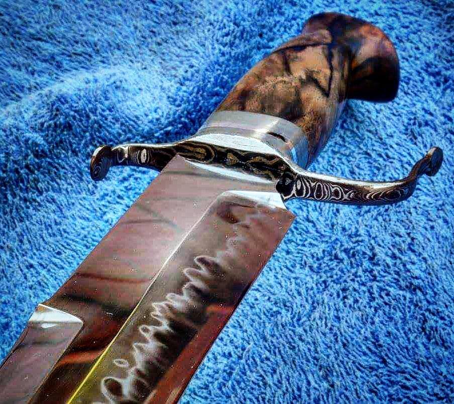

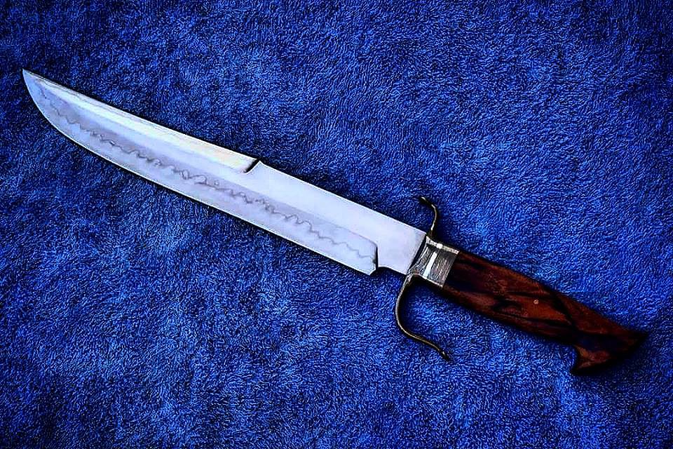

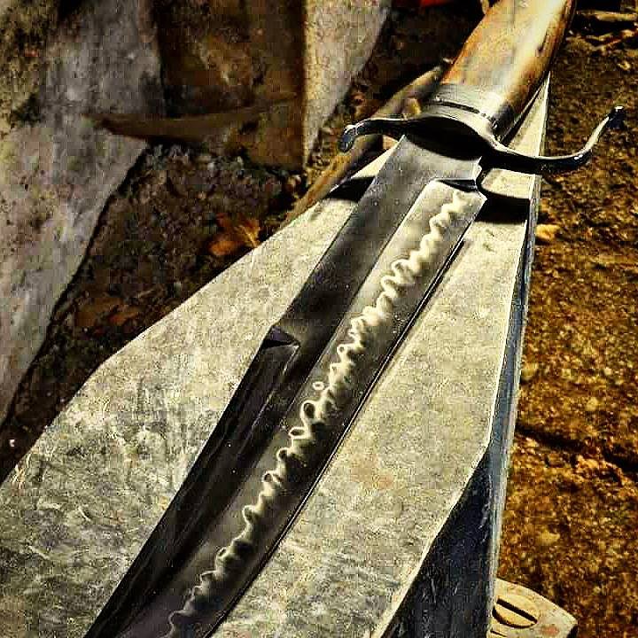

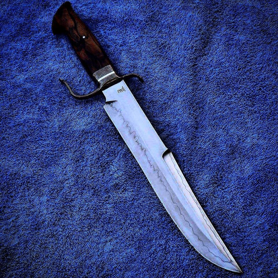

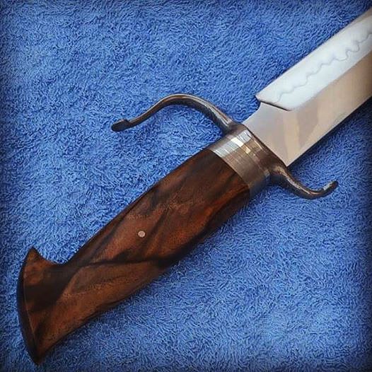

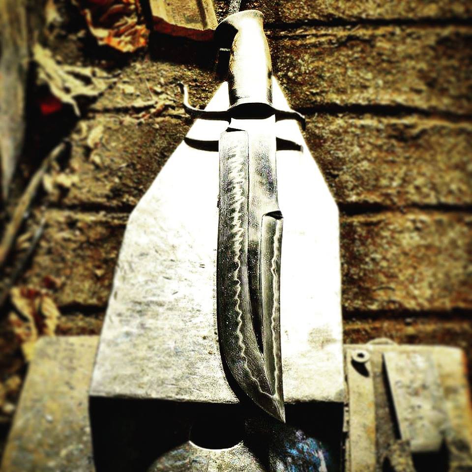

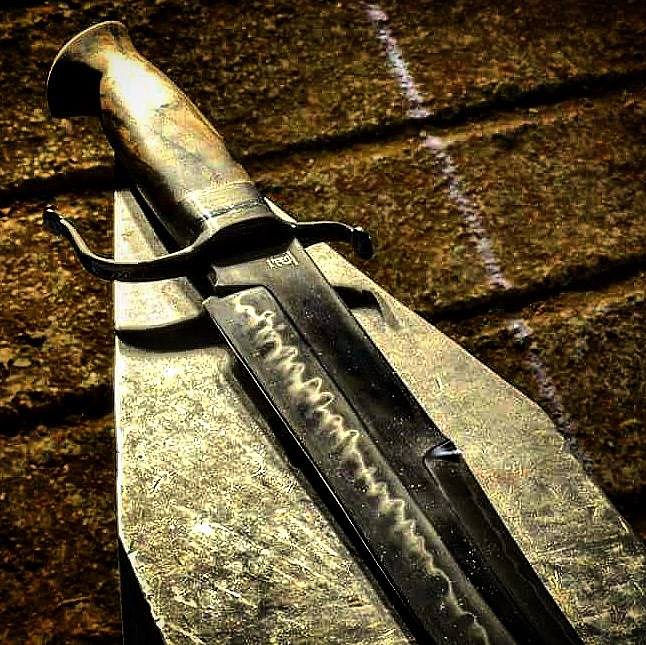

Hello all!
I´m glad to show you this piece, my last finished work. It´s a fighter knife, the blade was forged from c105 steel, and clay hardened to get a hamon. Then hand sanded to 2000 grit, and finally lightly etched and hand finished.
The guard an collar were made from a 100 layer nickel/steel damascus, with inox spacer and pin. The wood is a beautiful ancient walnut from Biniés (Spain). Its total lenght is 46 cm (about 18 inches). Im happy with lines and balance, but feel free to critique, it´s the real learning way.
Thank you all for seeing.
Regards from Huesca (Spain).
Pablo.
