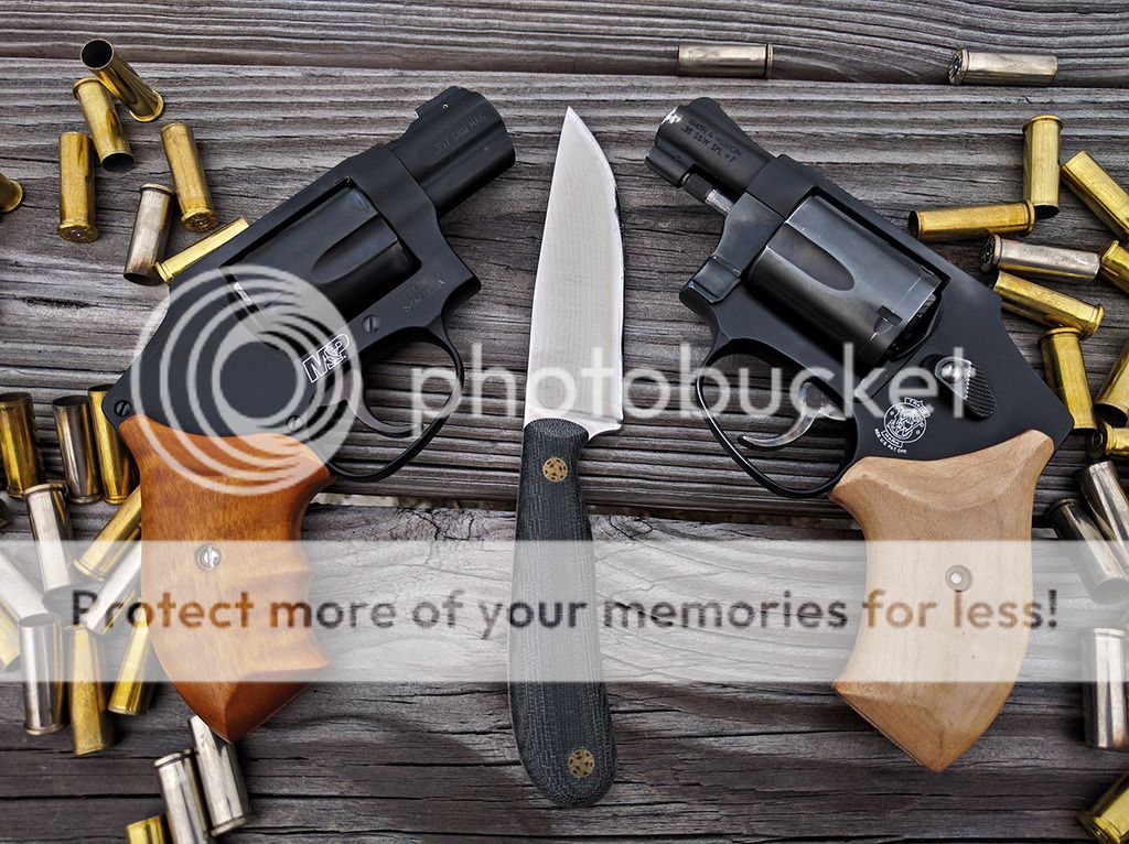

The "New York Reload" Snub Duo
The firearms used for this report were the Smith & Wesson Model 442 Revolver - No Internal Lock and the Smith & Wesson M&P 340 - No Internal Lock. The 442 is a popular J frame airweight revolver in the centennial style with enclosed hammer in an aluminum frame with a stainless steel barrel. The 442 is essentially a blued version of the 642. The weight is approximately 14.6 oz. unloaded and the barrel length is advertised as 1.875".
The Smith & Wesson Model M&P 340 is a J frame chambered for .357 Magnum. It is an airlite revolver in the centennial style with an enclosed hammer in a scandium alloy frame. Unlike the 442, the 340 has a shrouded stainless steel barrel, an XS tritium night sight, and weighs approximately 13.8 oz. unloaded. Like the 442, the M&P 340's barrel length is 1.875".
Here they are sporting maple boot grips by Kim Ahrends and his family and their crew, next to a good deal of brass and a Mini-Bowie by Ban Tang.

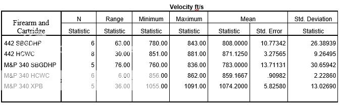

Subsequently, I was able to shoot the Speer round and the 150 grain wadcutter in the 442 through a Competition Electronics ProChrono Digital Chronograph. Following the test, I shot both these rounds plus the short barrel low flash .357 XPB through the M&P 340.
All strings were > or equal to 5 shots. The table below lists several descriptive statistics including range, mean, and std. deviation.

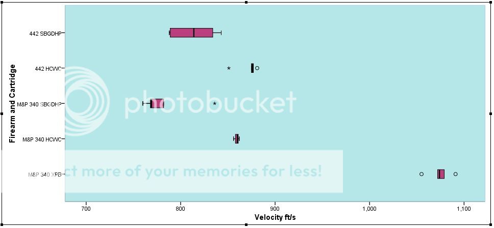

For visual learners, I arranged them in boxplots that show the spread of the velocity for each string as well as outliers marked by o and *.
Noticeable in this output is the relative low velocity of the Gold Dot 135 Grain hollowpoint, which had several bullets in the 760 - 800 range. The mean of the group was 808 ft/s for the 442 and lower for the 340.
The Buffalo Bore 150 grain hard cast wadcutter had remarkably consistent output and very low standard deviation around the mean for both firearms.
Both the SBGDHP and the 150 wadcutter traveled 15-20 ft/s faster in the 442 than the M&P 340.
I previously tested the SBGDHP in the 442 and achieved a mean of 838 ft/s. These results indicate that this 442 has lost velocity for this round over time, or that these batches of SBGDHP are on the slower side. a 20 ft/s difference in mean over time may also be attributed to chronograph error or other confounding variables.
Both rounds have somewhat stout recoil. My personal perception is that the 150 grain wadcutter has slightly less recoil in both guns. I must congratulate Buffalo Bore on provoking a heavier bullet to to travel faster in a cartridge with less pressure when compared to the .38 Spl + P Gold Dot.
It is also noteable that the Buffalo Bore 150 grain rounds were right around published velocity of the maker. Most of the Speer rounds failed to reach velocities published by Speer in their ballistics catalogue. However, they had reached those numbers in my previous report. The Speer cases from today seemed to have a little unburnt powder in them compared to the Buffalo Bore offering.

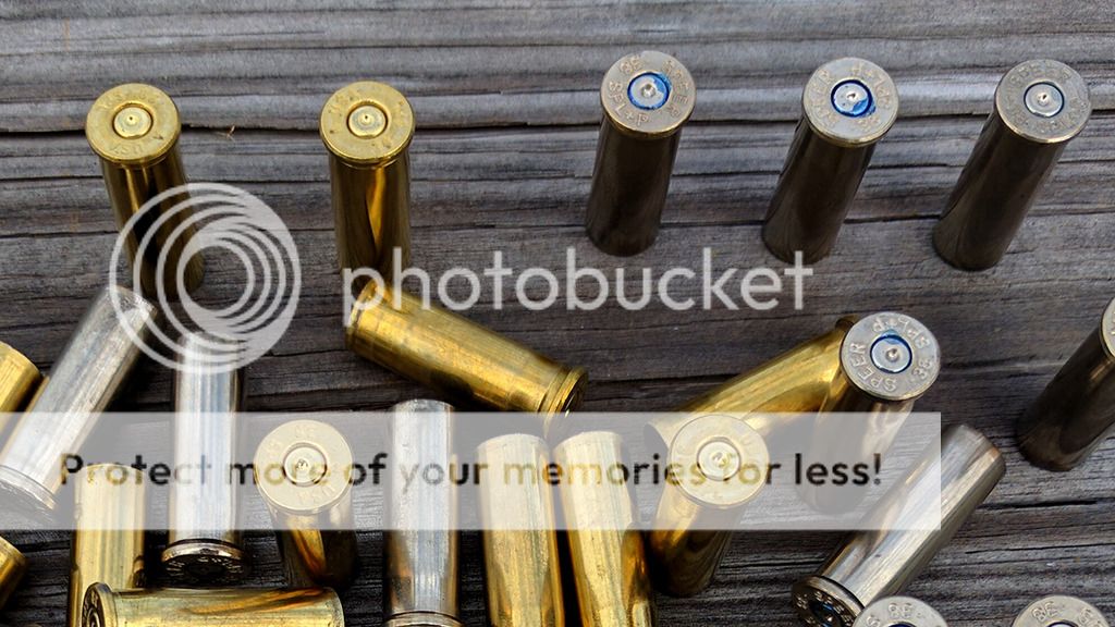

Primers and crimps were checked during the trip. This photo shows a sample of primers from the 442.
The SBGDHP showed no evidence of "jumping the crimp" or bullet movement on the fifth bullet after firing multiple rounds.
