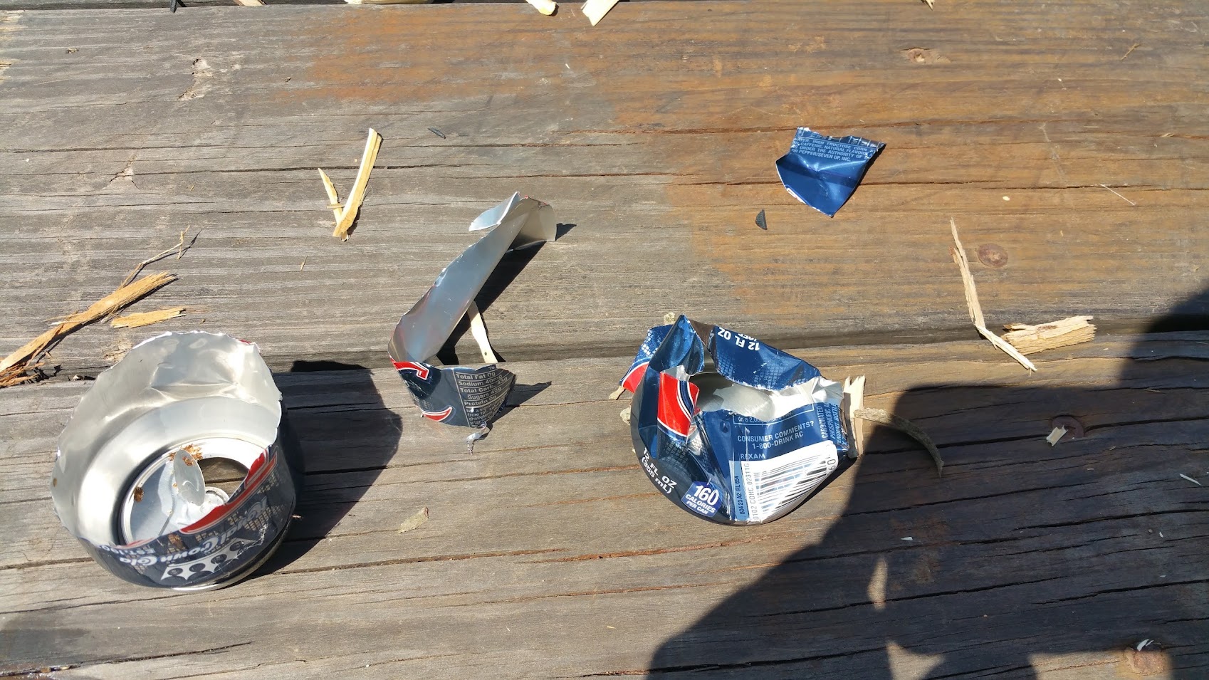

Next I cut 2 soda cans in half and sliced some strips into them. Edge looked fine.
mlY3TZ5Xsq9zyEX-c0WOn9LjAU0yNIu2erEH3hfkdPk=w538-h955-no

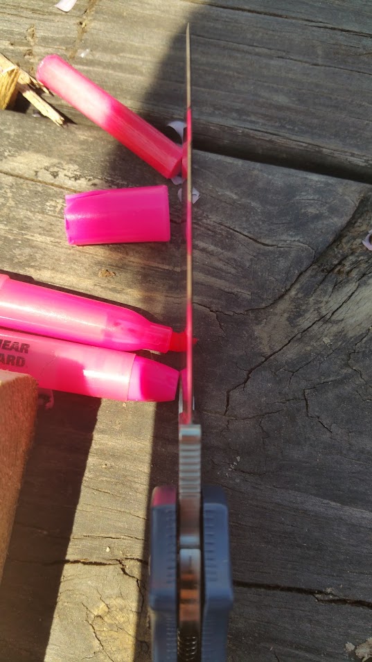

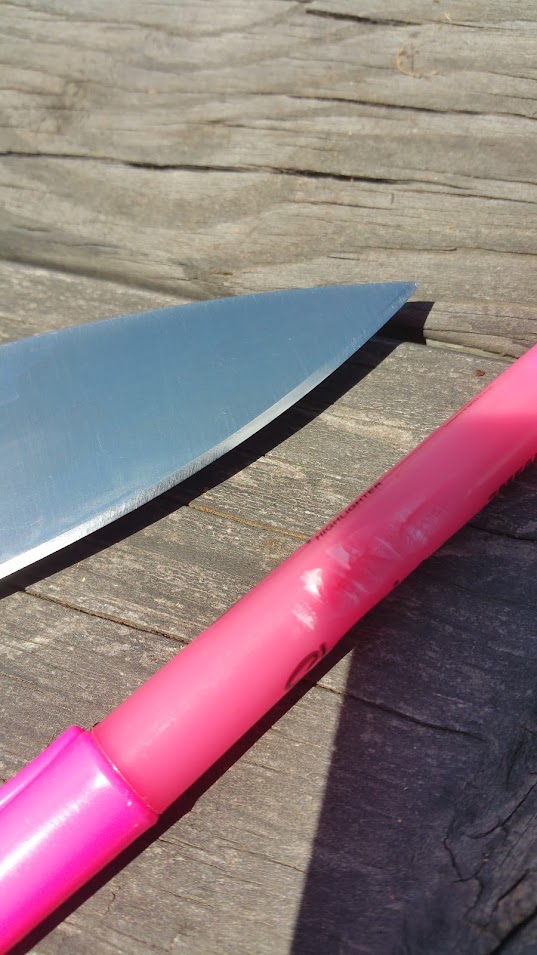

Next I found a small sampling of the average plastic somebody might cut plus a highlighter.
Before
VYtZODVy8rdu1U1Mezb6igloAjvFy3Ls6J3FiGP50IE=w1698-h955-no
After
3xOvb7lBLZtOXWK0QbcZy-yv3XVtCs34WtIlhru6Wvc=w629-h354-no
Edge still looked good
5nXtoYXtGeZxhIjf-3EsgmPmtCZcevpq2_rllH3MURw=w538-h955-no
Whittled on the highlighter.
AnCRc2FyL1Jb606sFN_AcOfRTvp04ld4T7AAdgezdvw=w538-h955-no
Tried to baton through which cracked it in half still looks fine

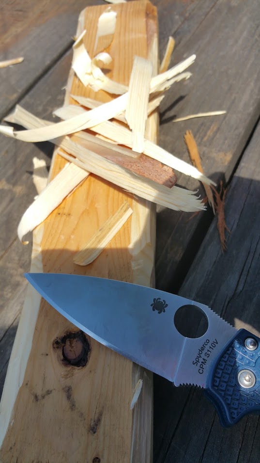

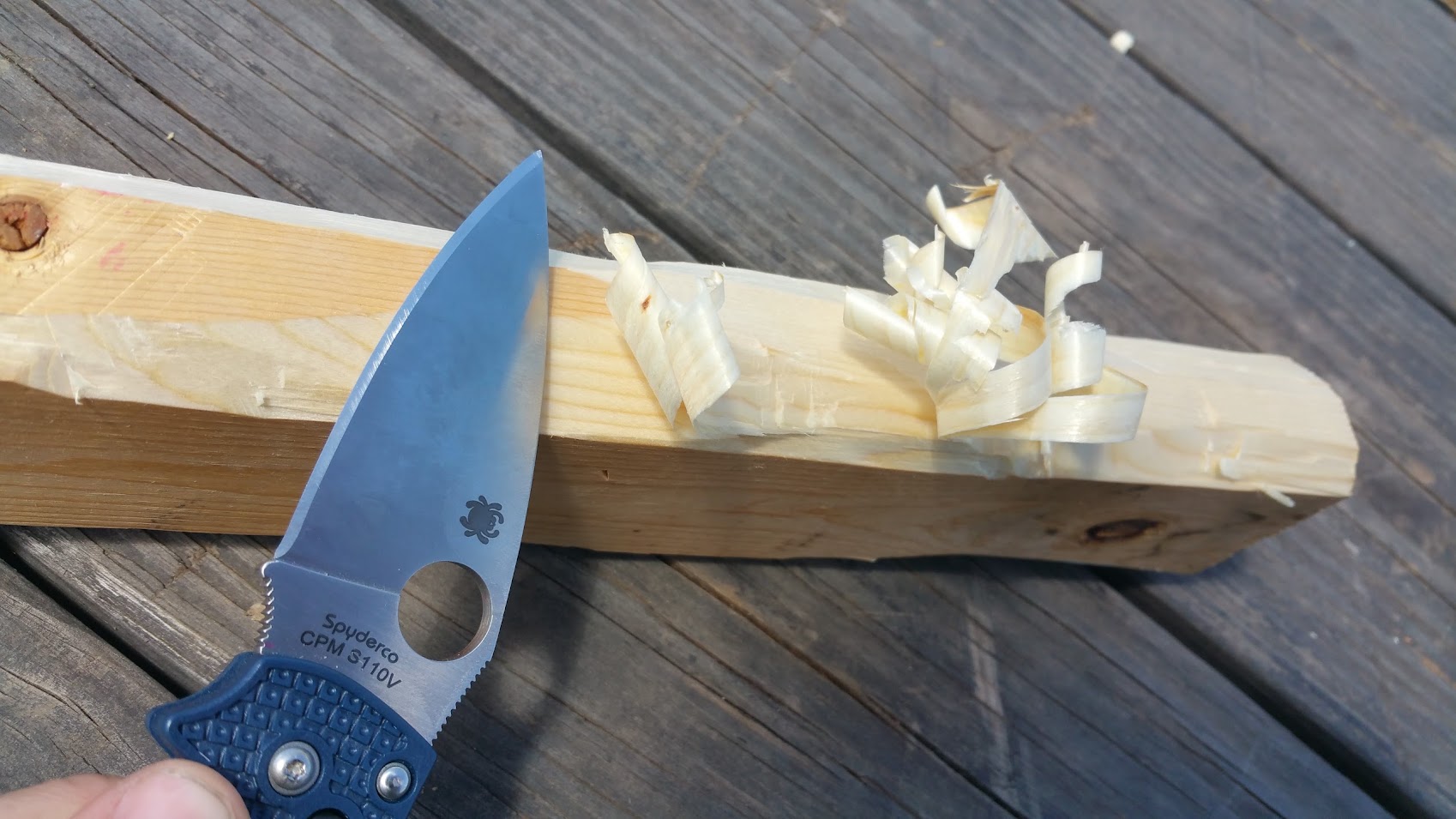

Decided to whittle a new piece of wood this time, it feels like it might be softer, but this is not meant to destroy the knife. I wasn't kind, there was a lot of impact and lateral torque

After
tNv-3qucNK1ADywglyVN_KOSSyjD09X1ofz02bLOX4s=w538-h955-no
gmJKQXxF2_cqF7_Yo7I8PQmYuJMIW07PyW-JKFm7v68=w538-h955-no

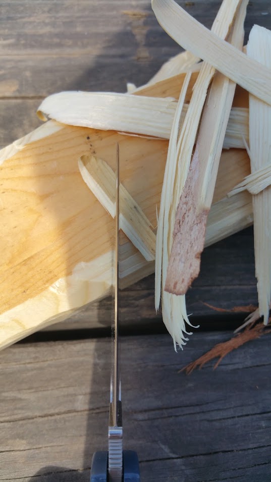

I then took a hammer grip on the knife and bore down carving into the block with a lot of force.
a3HaLUIK0o7eHFvvMMr5_UZClScvSag4rDh7ROvrPmg=w1698-h955-no
At this point I thought I saw some very imperceptible damage, This is a zoomed in picture showing some almost microscopic chipping, it is so small it may have been from where my 3 micron diamond stones were not broken in, hence the coarse scratches yet also mirrored edge.

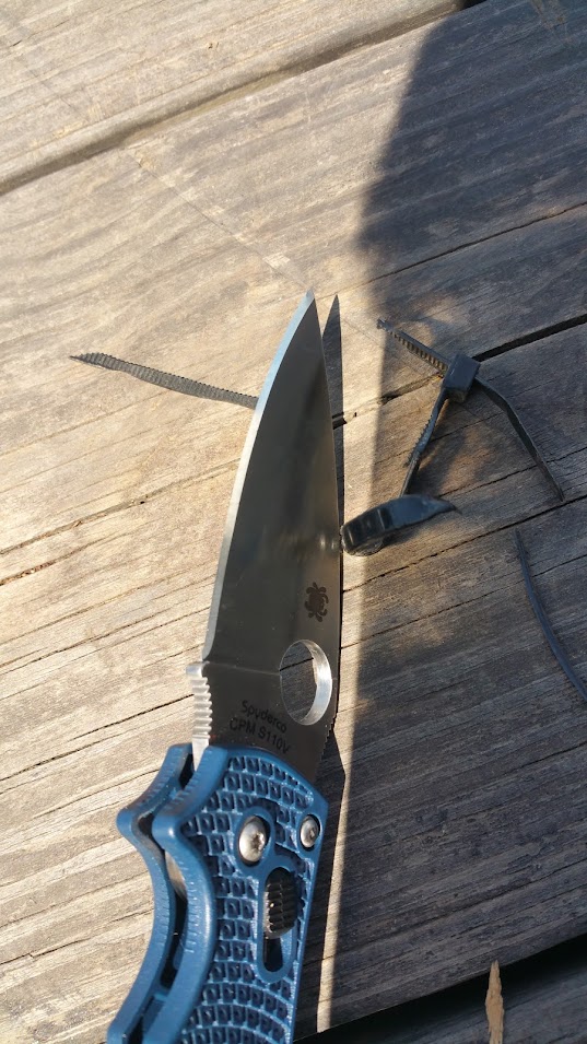

Wasn't s110v supposed to shatter on zip ties?
yQeAcor-WALh4HHb0C8OkMkT1-qo7xKJSlkHM_i5Am8=w538-h955-no

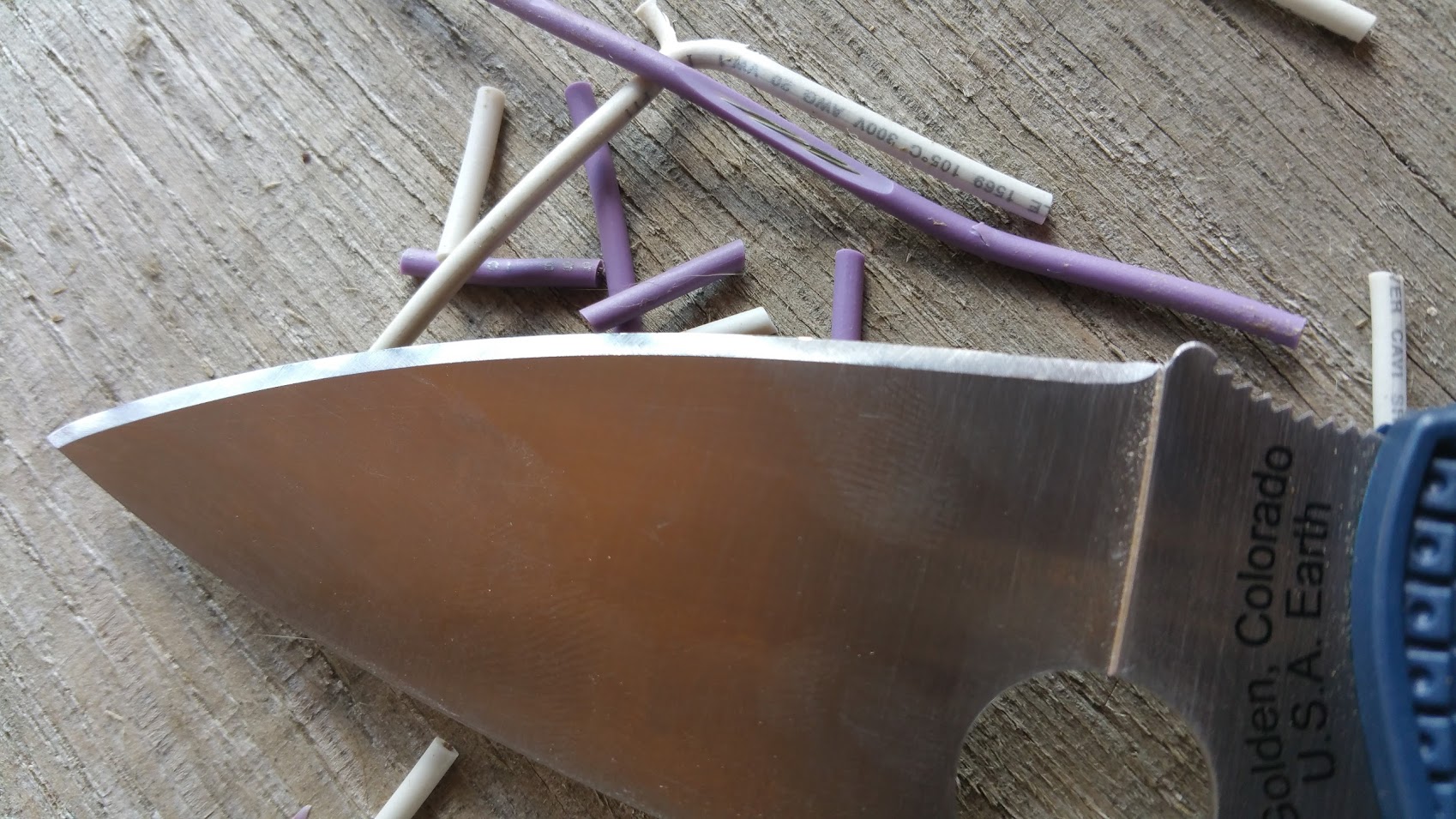

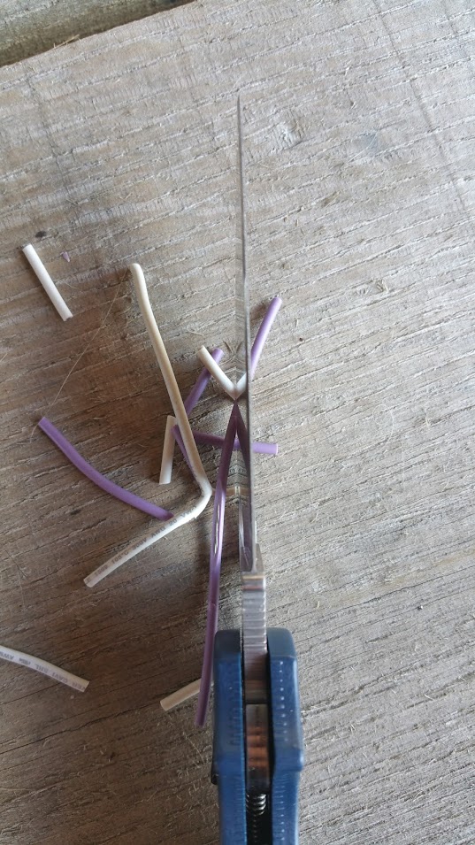

How about some thin wire, the type someone might actually cut, and not the enormous stuff I used in the past.
nq3OkXw3OUk_hQ4f3Dj_KDsVWpgSlhFjHGSf42kz2yU=w1698-h955-no
First cut was a really nasty lateral cut at the heel of the blade that stripped down the wire shaving the metal inside, this was the first incident of actual damage.
9FFhluFmL0pmyrhtq7ChWgRXJNVKHBAmMgSebqMMb-o=w1698-h955-no
Push cut several more pieces using the belly, didn't notice any damage.
45sfAfttsdlkKNiULkNWUQQsO2UWb8ChtgC9o1_k2Fk=w538-h955-no

Interestingly enough, what destroyed the edge was the soda can, now I made more cuts into it, if I had sliced it into a few pieces and did some draw cuts It might have been fine, but it wouldn't shave anymore after I finished.
Sc2E1_0Tn6GcQZ1lNNSaoasvIpiKgsWHe-G8HWTOZN0=w538-h955-no
99RNfbMkRAUxcwUOVbP1V7st8dmz2QKBpgfkAX9nz3M=w1698-h955-no
