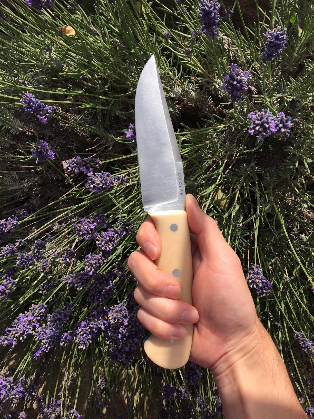

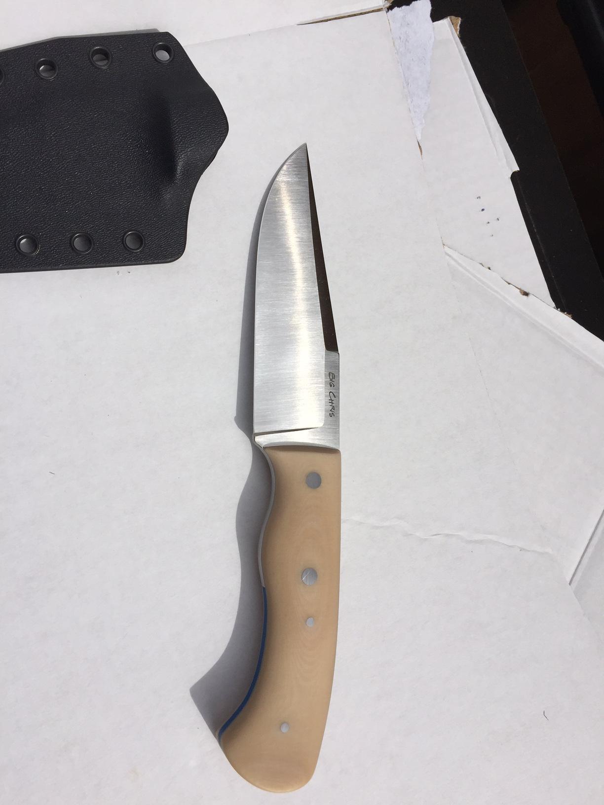

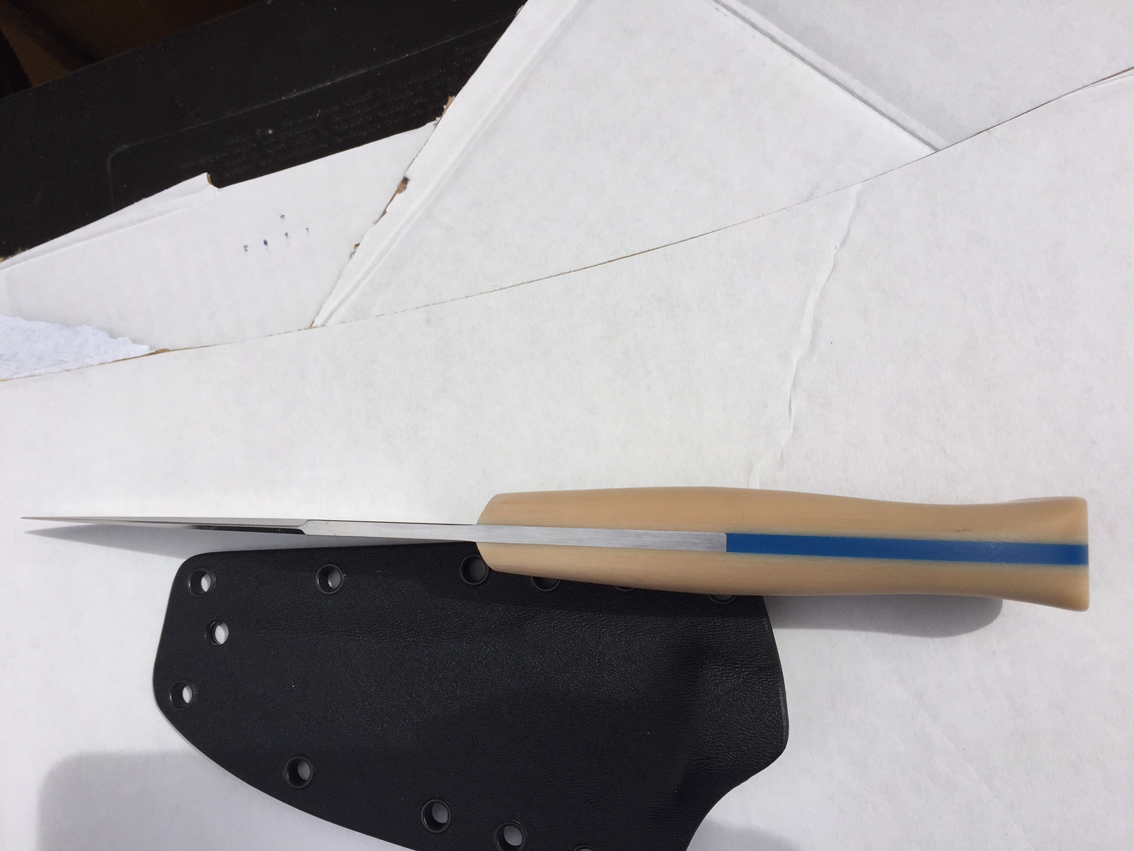

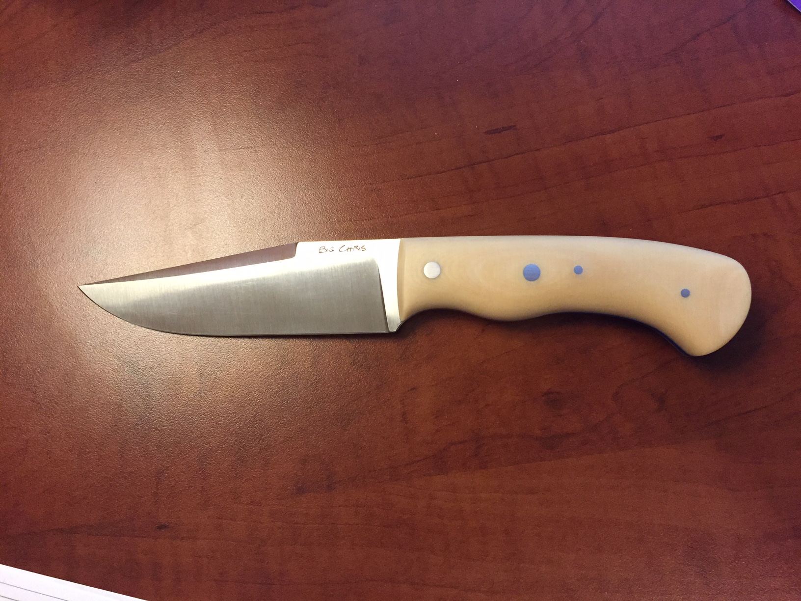

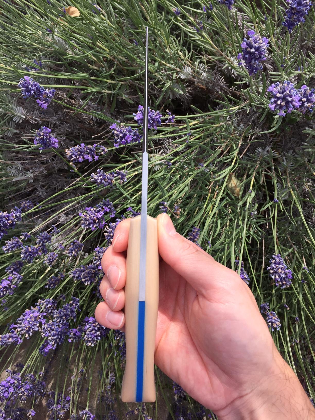

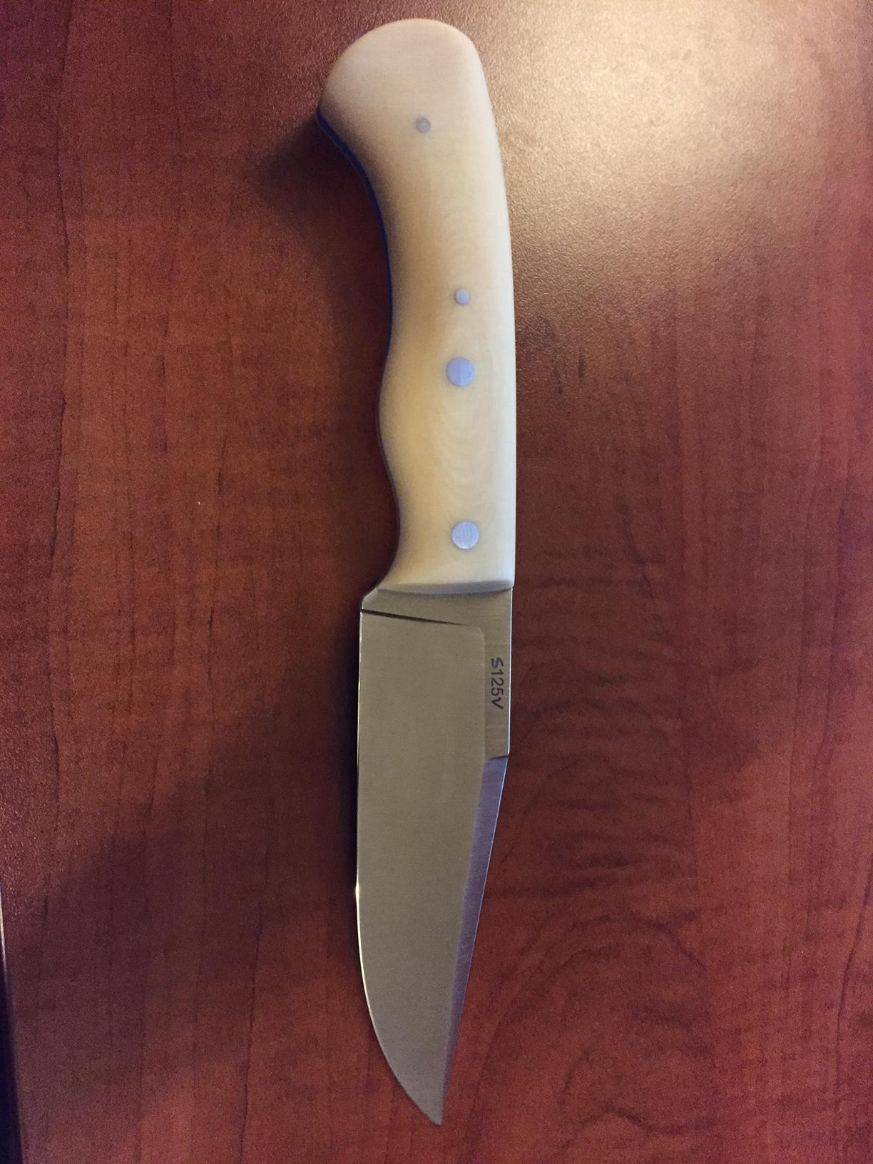

I received a beautiful knife from Big Chris a couple weeks ago, and wanted to share some of my initial thoughts. Two disclaimers: One this review is far from scientific and reproducible. This is not the intent, and for that I leave it to the masters like Ankerson. Two I have some experience with high carbide alloys, including a k390 spyderco mule, a bunch of s110v and s90v, as well as a Phil Wilson bow river in k294. I am looking to add some other A11 soon, all for the sake of testing, right? That said, I am far from experienced (and even farther from expert). Take everything I say with a grain of salt.
So some pics to start us off
This is a scrapper pattern, about 5.25 inch blade. 0.156 thick, heat treated to about 63.5 Rc. Fit and finish are extremely well done, and balance is just about perfect. These partial tang blades are really growing on me. I give up the dream of batonning through a redwood forest with an edc/hiking knife, but gain great slicing with excellent balance and feel.
