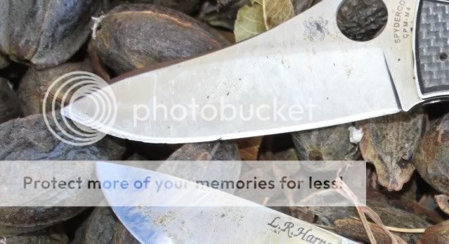

Here are pictures of the edge of my Paramilitary 2 in S30V. As you can see, there is a significant ship out of the edge. This happened when I was cutting a piece of TV coaxial cable. I was holding the cable bunched in a 'U' and gradually applying pressure until it parted. I wasn't wiggling or rocking the edge at all.
Is cutting TV coax abuse? Or should this not have happened? Should a S30V blade be expected to cut through plastic and aluminum cable without sustaining this kind of damage?
In other words, should I send this back to Spyderco for repair or should I just resign myself to the fact that I have a LOT of sharpening to do?

Hi Elkinds45, I can tell you that coaxial cable has a copper COATED STEEL center conductor that would screw the edge of most knives. It is very hard on my cutting edges of my tools ( I'm an electrician) so I only use a dedicated coax cutter for it and also to maintain the round shape for termination purposes. Sorry about your knife edge but this is how we learn, best regards, Andy.

I cut a truck load of coax & data cables with the GB (we are talking RG-59 and solid conductor CAT5) and there was nothing but a small flat spot on the blade. Never tried that with a Para2 though. M4 is used to cut other metal so that is what I think explains the results I got.
Also, quality coax be it RG6 or RG11 has a copper conductor (mostly the quadshield type), others have crappy copper covered steel conductor cable. That is what you cut through, had it been copper it would not have chipped it out.

RG-59 (the small stuff) is usually copper and soft so cutting it with a knife is not a big deal. RG-6 is a nickel core coated in copper surrounded by a stainless steel braid. Cutting this with ANY knife will do extreme damage to the edge. RG-11 is double the thickness of RG-6 and will only be found in extreme long runs from the pole or underground tap. If you could get a knife though RG-11 without a hammer I'd give ya credit, dykes hardly cut that stuff.
Also I'd be hesitate to call that a chip in your blade, looks more like deformation with possible tear out.
I don't know, but I would guess that there's a difference between a purely straight cut on metal (even soft metal) and an even slight sideways cut.
