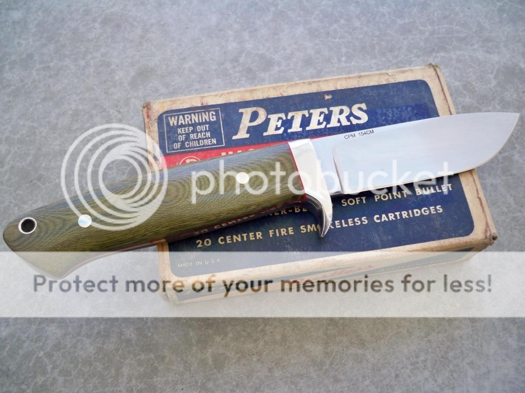

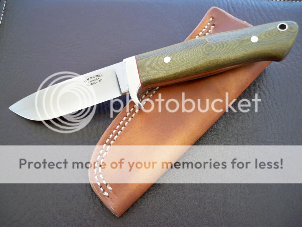

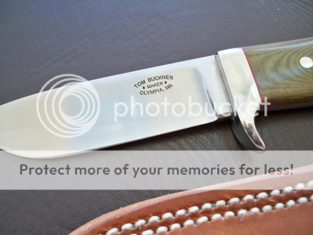

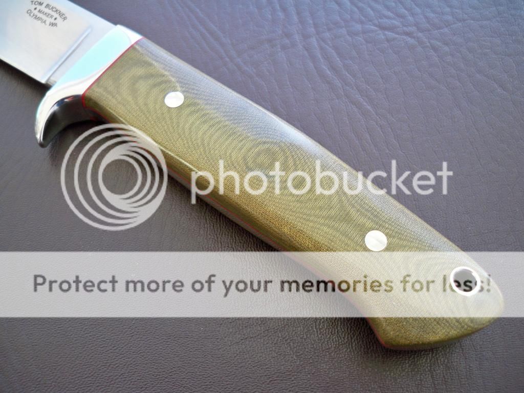

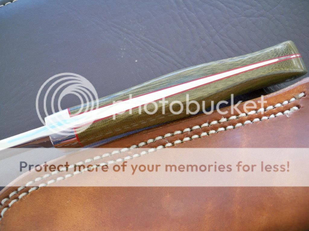

I am going to spring for a Loveless style hunter (for actual hunting use) and the maker I like will do either S30V or CPM154 for the same price. The only difference is he puts a mirror polish on the 154 and a matte finish on the S30. I own a few blades with both, I don't have a strong opinion either way. Do any of you? What would you choose?
Thanks
UPDATE:
I got lots of great feedback on my question and I decided to go with CPM154. I had this knife built by Tom Buckner of Olympia Wa. I met him here at the Eugene knife show, liked his work and commissioned him to build me a loveless style. Can't say enough about Tom, easy to deal with and aims to please. When he handed me the knife he said "I don't have any displeased customers, if you don't like it tell me and I will build you another one".
