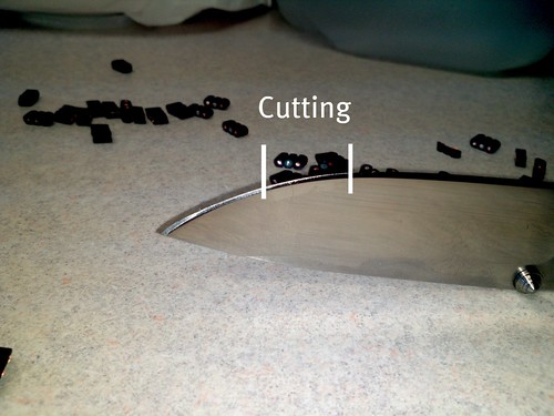

Some member (or s) wanted to see if a S30V Sebenza in particular would display rolling I figured I'd rather post it here then the other thread (since it was s35vn issue, not an s30v- the thread just left me curious as to how s30v would perform):
The cord I was cutting has maybe a little more metal content compared to the thicket orange cord, however less insulation. It came from an HP Adapter three pronged power cord (positive/negative/ground).
This was 40 cuts on a Power cord of an HP laptop adapter (charger if you will). It no longer shaved hair on the cutting portion (two white lines indicate the cutting portion).
No damage to the edge. Neither rolling or micro chipping, Ill check under 100x magnification at home.
sebbie cord by crazysur123, on Flickr
I am happy the edge took no damage, may just need a slight touch up.

Ankerson asked for proof on CRK's side because the post mention the knife being shaving sharp after 300 odd cuts on some power cord which made no sense to him. I am not sure why, I haven't seen his testing on S35VN so I can't comment. Depending on the edge geometry it's possible to keep shaving sharp if the cuts were shared on the entire length of the blade. It took approximately 18 cuts before the shaving sharp went away.

Anyways I did the test mostly our of curiosity and felt like sharing the results.
Any steel that cuts through cord like this with no visual damage is good in my book.
