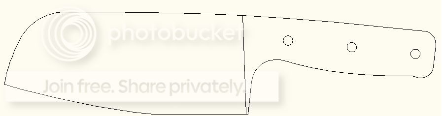

Does anyone have experience with S7 for any type of knife? I have a large chunk of it sitting in my shop from an old tool. I would like to use it for making a few kitchen knifes, and possibly other types of knives as well depending on the consensus.
Is it a good knife for cutlery? Would it be good for a drop point?

It actually is soft now. I plan to drill and ream the rivet holes, send the piece out to harden, and cut the knifes out with a wire EDM.
I should be able to make around 12 of these out of my blank of material.
