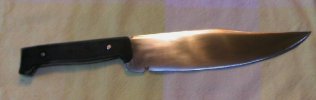

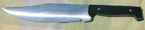

First I wanted to say thank you to everyone who posts here on the forum. Sharing your information, giving encouragement and leading a hand when you can would just be the start of a list of the good things that many of you do. I do not think that thanks is said enough. I would not have even started out trying to make a knife much less finish one if it hadn't been for this forum. It is a poor pic but I will get my brothers camera and get some better ones (I couldn't wait sorry). One thing that I learned making this knife that is often said to folks just starting out is "start with a smaller blade", well I will say that is great advice and I wish that I would have followed it. Most of this knife was done on a 1"x30" Delta sander and finished up on a 2"X36" Multitool. The heat treatment was done by Roger Linger (many thanks Roger). Any comment welcome but try to be kind
. Thanks for looking. Here are the stats
S7 Steel
14.5 inches total
1/4 inch thick with alot of distal taper
Convex grind
micarta scales (started out with Bloodwood but messed that up!)
57 Rc (which gives 125ft-lbs on the Charpy C-Notch)
Hand rubbed 600 grit finish
