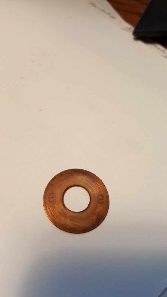

i have a 2009 21 large , bought new sat in safe, now i want to use it for edc but grease dryed out cleaned it but action sucks, was cleaned and lubed by another person that knows the knives , still not right very hard to open not smooth at all.. open for suggestions

I just pulled a 2008 out of the archives and it was smooth as glass, but I did notice that the washer took on an imprint, I see it did it twice, probably because I took it out a few years ago and opened and closed it a few times.
Every time I've experienced a stiff action after cleaning it's been the result of a pinched washer. I say have another go at it.

I've managed to do it both ways. Some of us are just good like that. I assume it was pinched washers as they worked perfectly after reassembly. FWIW I now assemble the handle first and then insert blade and I haven't had any trouble on my last few attempts.
The tolerances are so tight that if you assemble the handle first, you'd have to work to pinch the washers. If the washer is over the bushing when assembled sandwich style, layer by layer and tightened you can put the smallest little dent on the inside of the washer in effect making the washer thicker and consequently making the knife stiffer. Most times use will work it smooth.
I took mine onto a ceramic stone and when I polished it I could see the high spot where it was pinched as being shinier than the area directly adjacent to the pinch. Now I'm not tellin' you to use a ceramic hone to smooth it down but a fine ceramic hone will remove the least amount of material from the washer there by taking longer to really screw it up. ;) :)
