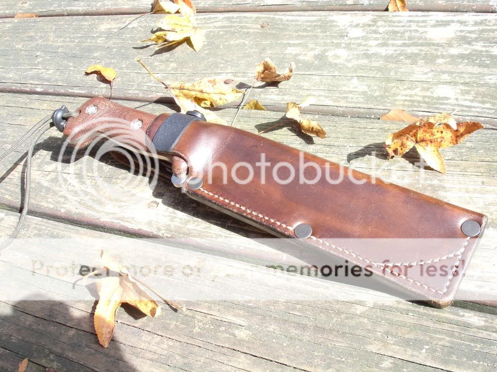

Ok guys... This is a review long since coming. Goose was generous enough to send me a BK7 sheath a couple months ago. I told him when he sent it that I would give him my honest feed back on it and let him know what I thought about it all and what he might/could do to improve it (if at all).
So first of all. I didn't take a pic of it when I first got it, so here is a picture of it from his web page.

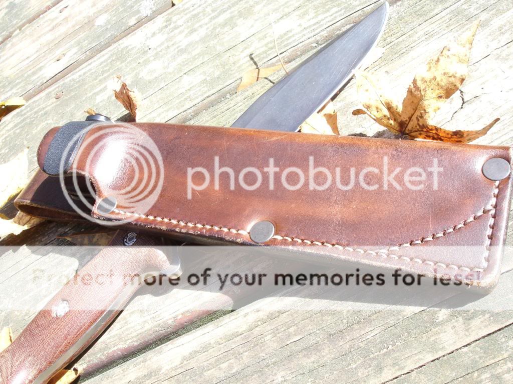

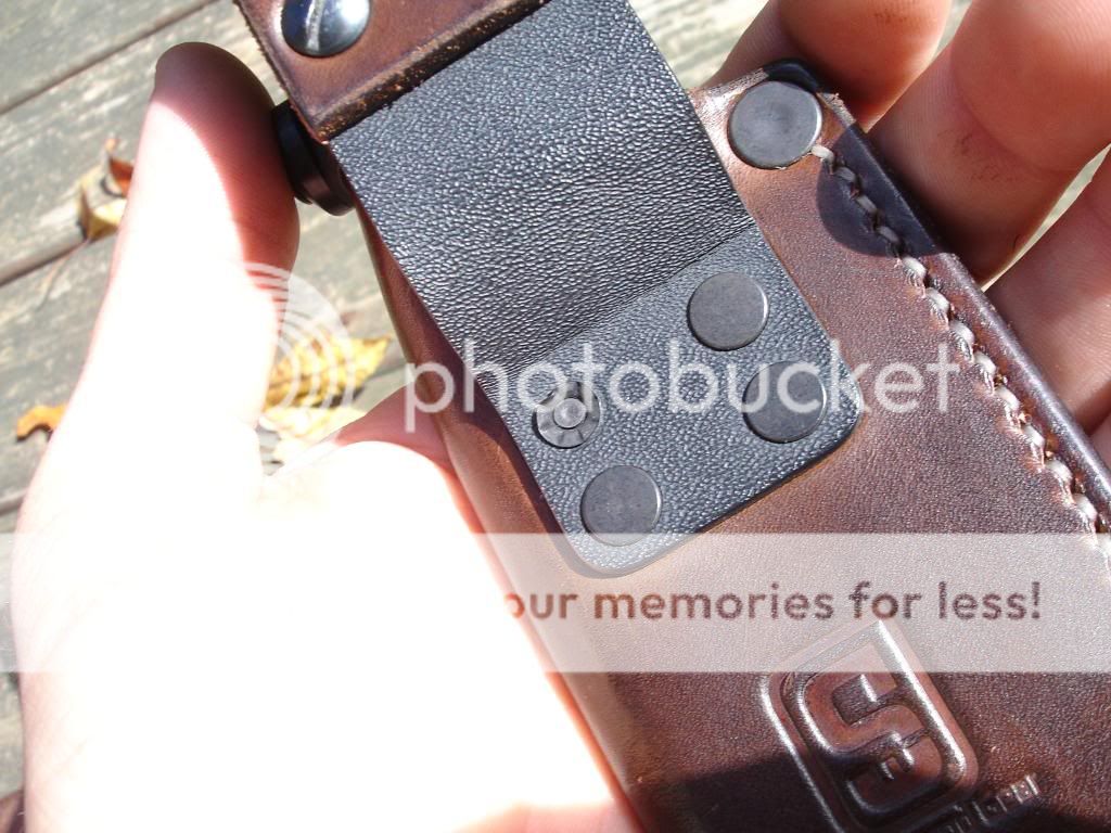

Let me start off by saying that this is a very well put together sheath; very tough! I spent a good 2 -3 weeks carrying this thing everywhere I went. One thing that happened (due to no fault of Goose's design) I bent the kydex and popped off one of the rivet backs when I was getting into my car. If I had been more aware when I was getting into my car that would have been avoided. Regardless of that the sheath is still just as strong as it was before.

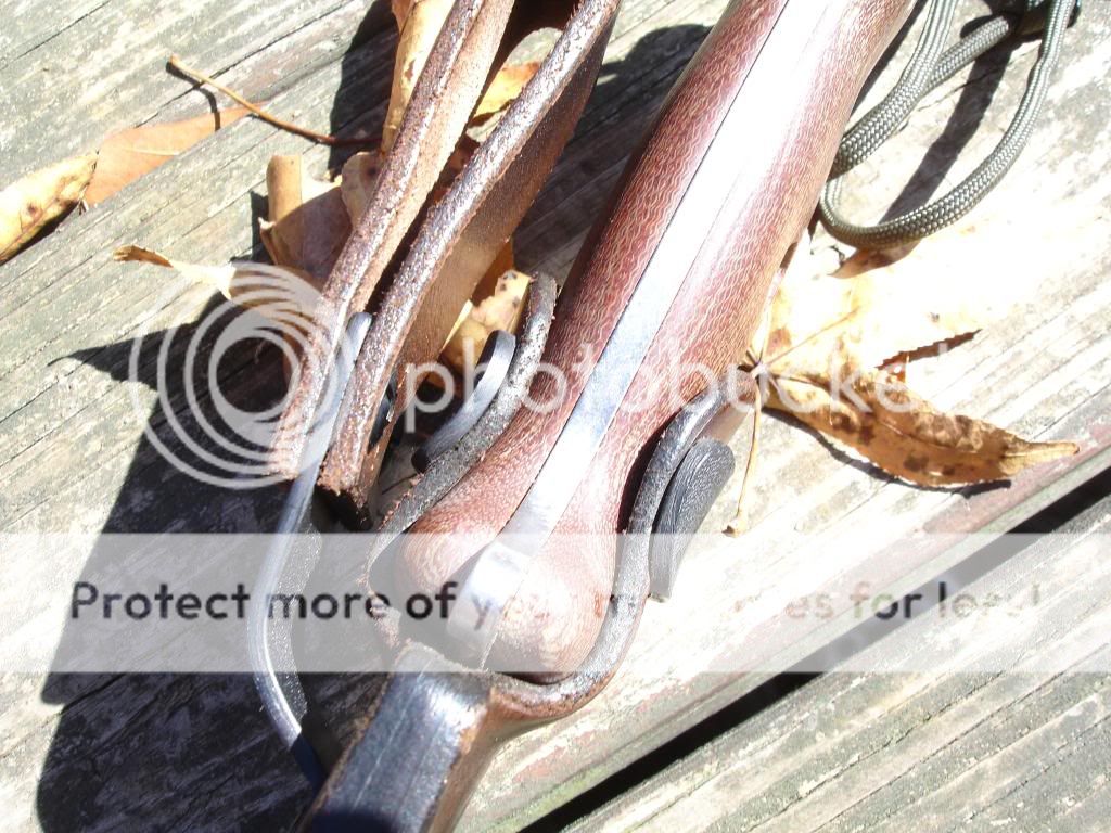

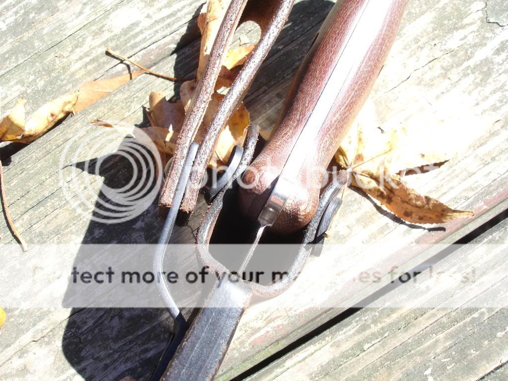

The retention on the sheath is great!!! It was a little tight at first, but after about a month of pulling the knife and putting it back loosened it up a bit. So she slides in and out very smoothly! Goose did a great job on the retention system. He made a reality of what I had originally wanted to do. I just couldn't see what he did to make it. Great designer and visionary!
The edges on the sheath are great! I was able to scratch them up a bit with my heavy use, but they will easily buff out smooth again. If you don't know how; just moisten the edge a bit and buff it out with a cotton rag/cloth.
Overall Goose's sheaths are very stout and durable! I recommend them to everyone who is looking for just that! So if you're like me and don't like to have to deal with the retention straps of conventional sheaths Goose at Sagewood Gear is a great option!!!!

That was actually the first prototype sheath I made for the BK7 that I had given him. They have come a long ways since then. I now do the double stitching on all the big beckers (2,7,9). I also went with .125" kydex instead of the .093" for the collar and belt loop bracket. Those rivet have been replaced too. I was originally using 2 piece rivets(well 4 piece if you count the little covers they have like that one that popped off), now I use solid tubular rivets. When I set them, I wet the leather near the hole, which allows them to compress the area around them, setting them below the surface of the leather. That means the interior side of the rivet is well way from touching the blade, and will not scratch or wear off any of the surface. These new rivets are on there so solid now that you would end up tearing the leather before you ever got that belt loop to move (and good luck trying to do that :D ).
