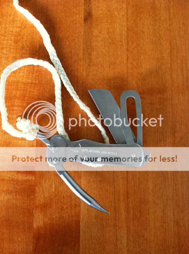

This is the rigging knife I have used it is not great, it's just ok, but if you are pairing it with a Vic farmer it should work.
The things I like about this cheap Teto knife:
Screwdriver on the tip of handle, no need to open.
Marlin spike is best feature locks in place by moving the shackle.
A shackle key.
And least of all the blade.
It's also all stainless which is 15 year old proof.
I don't know if you can still get a Teto but I think they are made by Davis.
