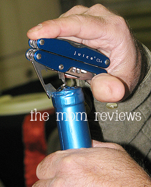

I wish Victorinox would make a high quality waiter's corkscrew so you could multiply force with a lever and a fulcrum.View attachment 436096
That would be nice. I'n the mean time you can get any Leatherman juice to do that job for you. ;)
NOT MY PICTURE
http://1.bp.blogspot.com/_9t3eLILuV8s/TPgCHtzjZII/AAAAAAAAHT8/5zIB9jBRuO0/s1600/tool2.jpg
NOT MY PICTURE
A cautionary here. Dedicated assists have two points of contact for stability. Notice that the CS4 provides only one arm on the assist. If you are not very careful, it can slip to one side or another in use, resulting in a chipped bottle lip or a sprung tool that will need to be fixed. Both happened to me on different occasions while trying to use it. When it came back from Leatherman Warranty, I just disregarded the assist and used the corkscrew like on a SAK; that is, screwed down all the way, lever the cork till it breaks adhesion, then draw it out. Or, if you have the strength, just pull. Better yet, use a dedicated corkscrew.
