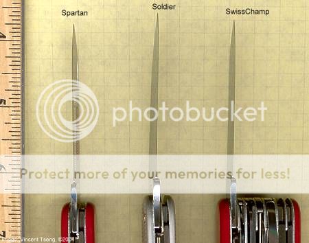

Paul is correct - I have answered this over at SOSAK already -
but for others, this is an interesting thread, from some months ago, in the Blade Discussion Forum -
Twisted SAK blades?
It's more than just the Soldier and other 93mm Alox SAKs - most the SAKs have twisted or "crinked" (to use the correct knife terminology) main knife blades to fit in with the other tools (the crinking may be less - but nevertheless there if looked for. The SwissTools may be the exception since they do not have overlapping tools on the same backspring).
