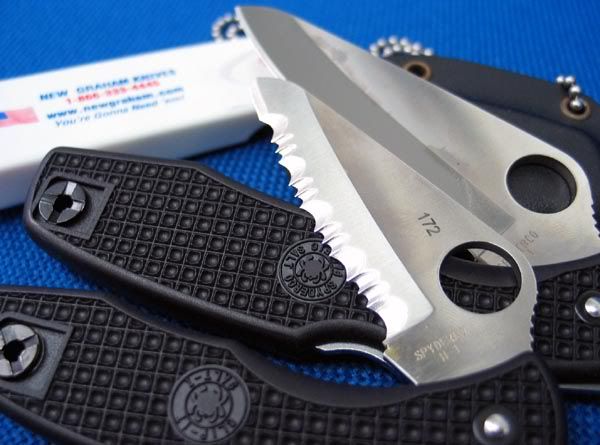

Salty goodies! Samo's H-1 Spydies..
Sam
Sam,
Your knives will ship out today. Sorry for the delay! Thanks for the pictures.
