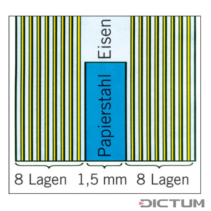

The best method is to use two core pieces on warikomi and ni-mai. The below diagram shows suminagashi warikomi with multiple layers of iron and medium carbon steel on the sides, but the core is what we are talking about. The dark blue is high carbon steel and the light blue is iron. If the sides were single pieces of the same low carbon steel as the top core it would be what I am saying. If you don't read German, the edge steel in this diagram is "paper steel" (high carbon Hitachi white or blue paper steel) and the spine core is iron. The term "iron" is used to refer to low carbon steel by Japanese smiths.
Dictum and others carry this steel very reasonably. I use it often on high end kitchen knives.
719618_01_G_WE_8_Japanischer_Mehrlagenstahl_Schneidkeil_Blauer_Papierstahl_WZ_jpg.jpg

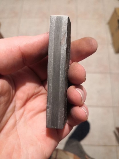

Hopefully this isn't too old, i finally had a go at this the other day. The first attempt with a wrapped cladding failed, but the second one i MIG welded the outsides first and seemed to have some success. I think my problem is I'm not getting it hot enough, which is mostly practice. I would rather learn to do this without a modern welder
I did find the laminate billet didn't move as easily as i would expect. The core was 26c3 which isn't bad to forge so i assume it's due to the overall construction
The tang was part of the laminate and it survived being drawn out to that shape, so the welds aren't terrible
