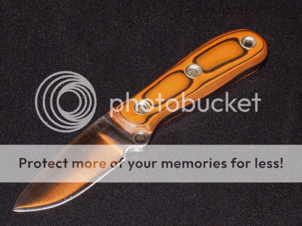

Here are some pics of G10 slabs I decided to sand down.... I used a scotch Brite Wheel with a drill and finished off with 800 grit sandpaper by hand..

Thank for the help, I was worried it would get messed up like some plastics do when sanded and loose color or something. Thanks for thoes pics too, I like the look of that orange knife!
