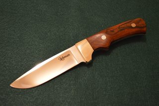

When I use CPM 154 I hand sand to 400 grit and the edge is as thin as I will make it. I send my blades to Paul Bos heat treating. They come back perfect. there is no scale on the blades. I then start with 400 grit and go up to 1200. I used to send them off after 220 on the grinder. It took a long, long time to get the 220 scratches out.
When I use a steel like W-2, I will go back to the grinder after heat treat, so hand sanding to 400 grit is a waste of time.
I agree with Tom Lewis. When grinding stainless steel I finish the blade to almost done except I leave 25 or 30 thousands on the edge to avoid a warp. I also use Paul Bos heat treat and the blades come back looking great and I need only to take the edge down to final geometry and use a very fine belt slow to finish. I can do a high polish from there easily ( of course hand sanding to at least 2000 grit ) or use a 400 grit cork belt and finish with a ultrafine scotchbrite belt. Larry P.S. The photos are two different knives. LL
