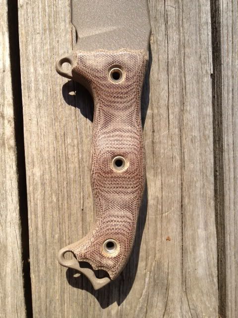

Sanding down handles
100 some odd grit sandpaper to really remove material, and about 220 grit to finish it off and smooth it a bit.
Produces a lot of dust, and isn't the best to breath in.

Thanks for the info, I just acquired a 3b2 and love the smooth handles. I want to smooth out my handles on my hellrazor.
I wet sand to keep the dust down. I use Klingspor cloth backed sandpaper. I start with 80 grit for shaping, then go to 220 and 400.
These are my NMFBM scales that I sanded myself. Much more comfortable now.
