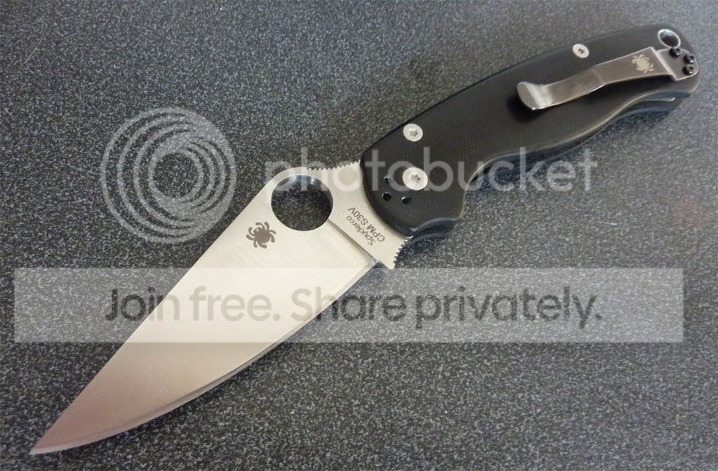

Sanding G10 on my Paramillie 2
Oct 16, 1998
1,697
and mounting the clip the other way around.
More photos if you click on that !

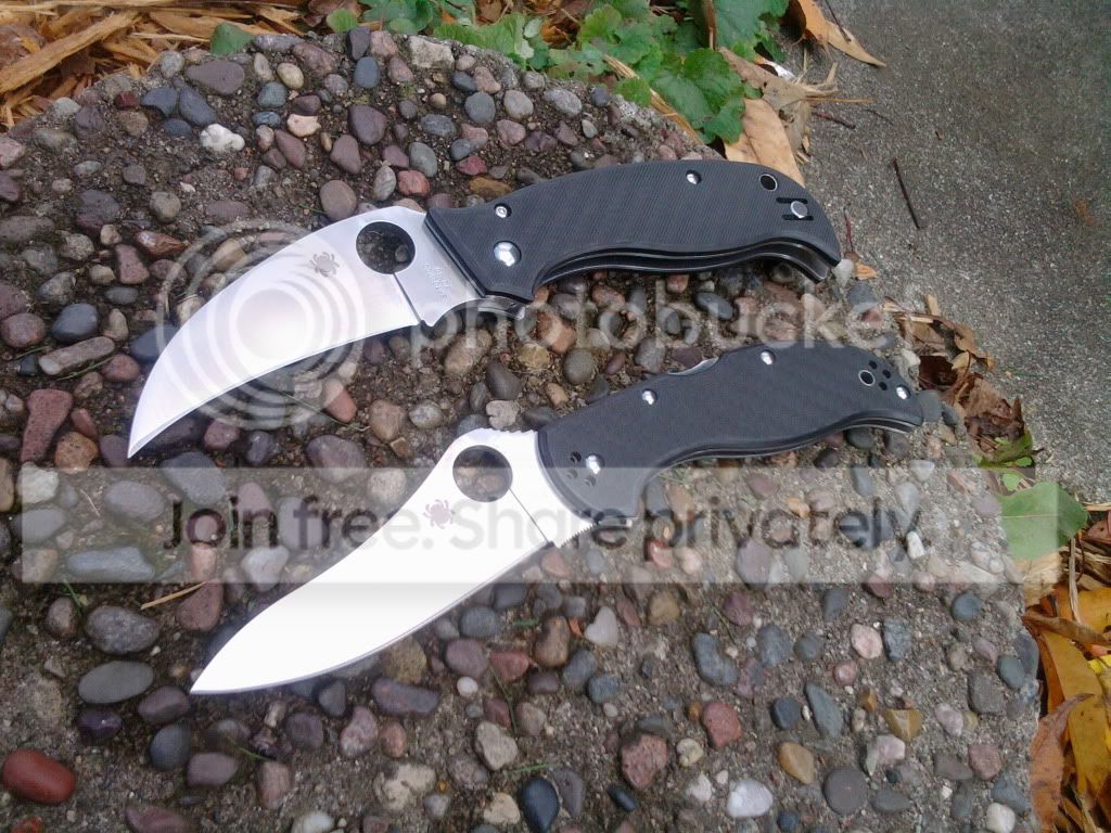

So am I the only one to sand his G10 Spydies ?
Cheers
Nemo
I sand the G10 (and plastic scales) on Cold Steel folders, but don't "melt" them the way you did. Thats looks pretty nice.
Looks awesome. I was thinking of doing this to my zt 350 a while back, but didnt know how it would turn out. Im going to be doing this soontimes
Wear a mask, work outside. beware of the G10 dust is very toxic (like breathing glass!)!
Take your time. The G10 dust is white/grey so it looks bad when you sand it.
But after it's cleaner.;)
Sweet, thanks for the heads up and did you apply a finish to it after sanding it? Also, what grit did you use?

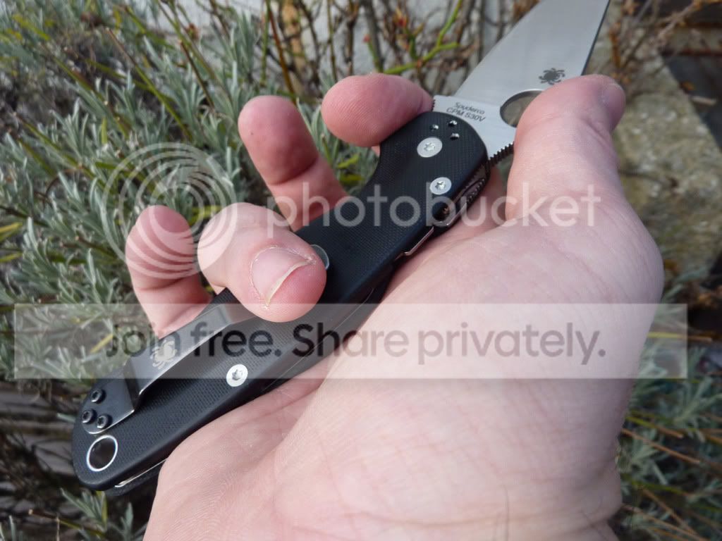

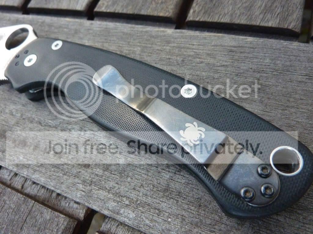

It's sandpaper for wood and the grit: 400.
Then for the "melting effect"
I have used some white polish for metal until I was happy with the result.
Then hot water and soap.
Relube and it was good to go.
One hour job.:)

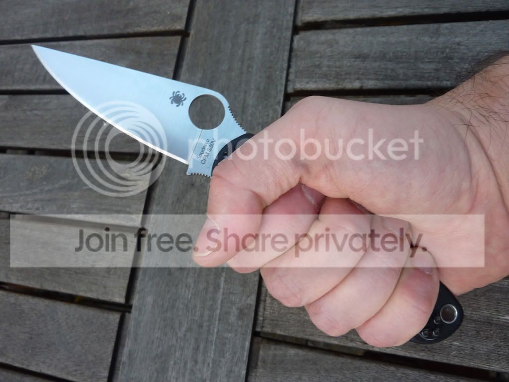

I wanted the handle to be very confortable for hardwood cutting tasks.

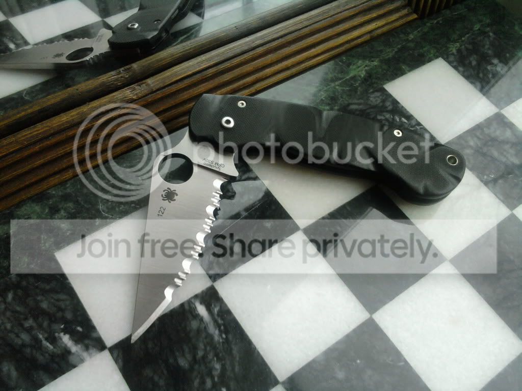

I don't like the roughness of most G10. I sanded down my lefty Military using 1500 grit wet-dry under running water to keep the dust down.
No pics at the moment, but mine turned out very similar to yours, perhaps a touch less smoothed out. Like the pics, the texture on mine is not completely even and would probably be a tough resale. However, the LH Military is a keeper.

You know, a few years ago someone took an old style Manix and gave it the melt/polish treatment. That was about the sweetest knife I've ever seen on BF.
Maybe you should very gently round over the spine and polish up the blade a little on your P2. Just a thought.
Found it. Here is the Manix I was talking about.
I'm going to melt the edges of my CF model just a bit. The edges of both my CF Spydercos are very square and just a little uncomfortable in extended use.

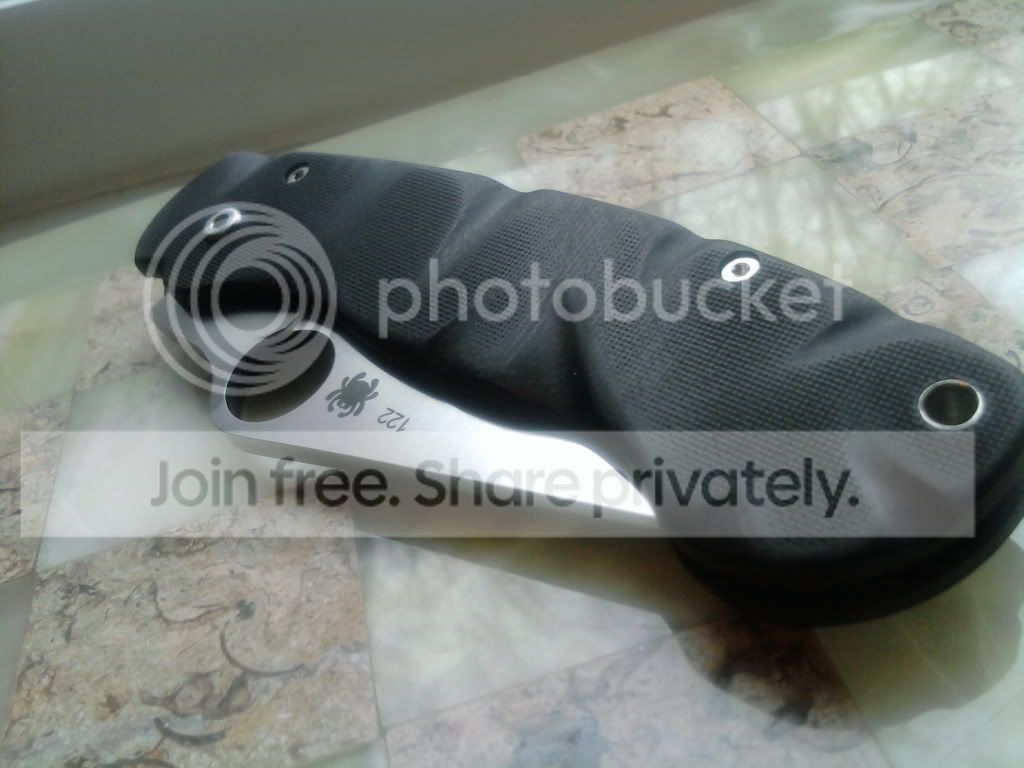

Here is a para I sanded.
The millie got a light sanding and the tenacious was smoothed out quite a bit more. I also took a good amount of its spine off.

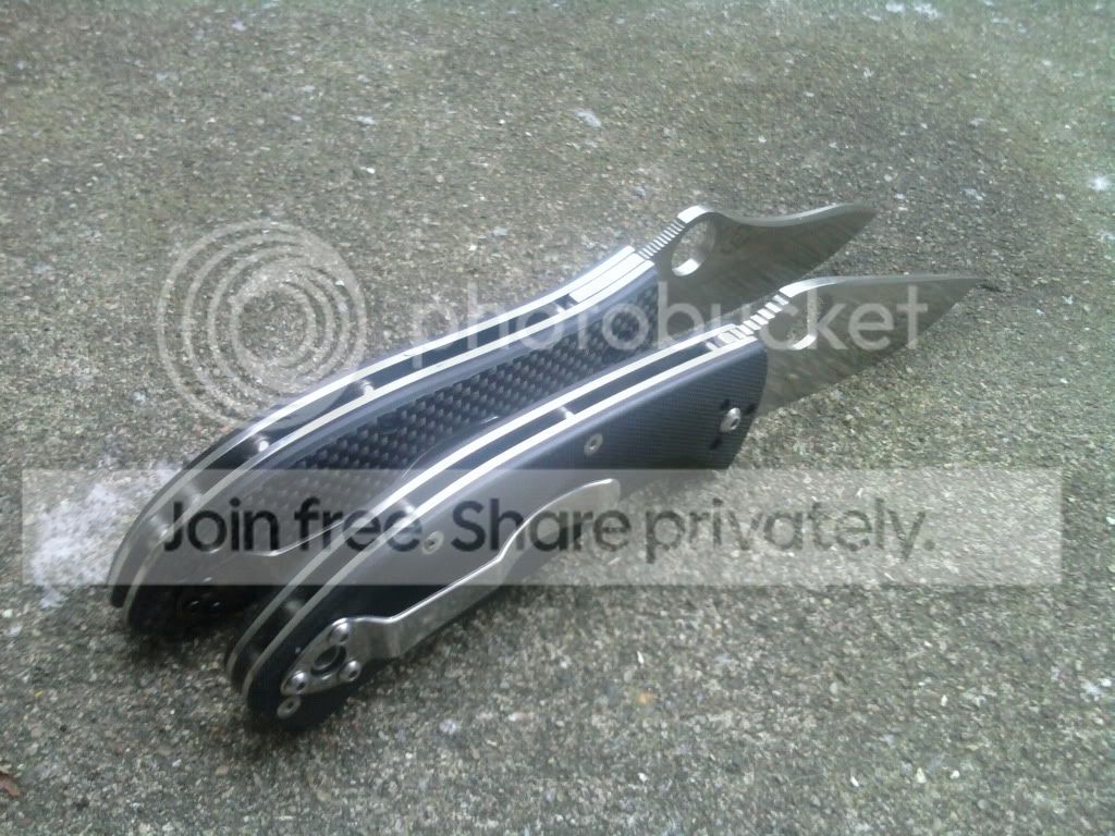

If your going to do any ply peel knives I suggest giving the whole scale a light sanding too. Its amazing how the cf comes to life after even a small amount of sanding.
Stretch before sanding:
And after:
