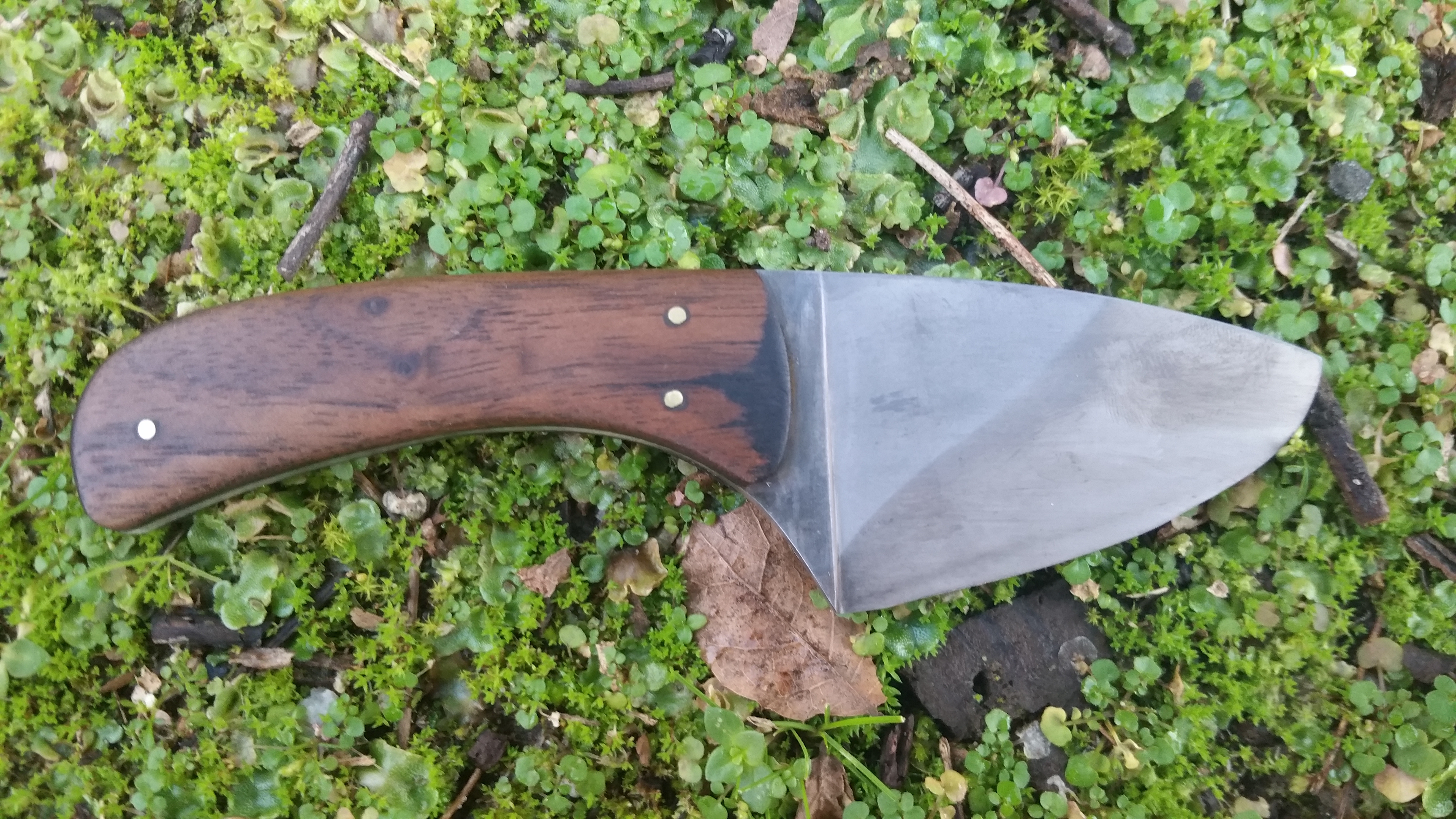

When making a full tang knife that will be etched, and the scales will be fastened in a non-removable manner (pins and glue), what is the best way to go about shaping the handles without ruining the finish on the metal?
If I go glue them on now, and do the last little bit of sanding, I'll probably scratch away the finish on the tang. Can this be re-etched after gluing and sanding without ruining the wood? (Walnut and vinegar in my case)
Ideally I'd have my sanding 100% done BEFORE I glue, but my pin holes ended up just a hair too big, so there is a slight bit of wobble, making it hard to get the handle scales exactly right.
Oversize holes make it a little tougher to do, but when I need to shape handles in the manner you're talking about I like to pin them in place with roll pins, do the handle shaping and finishing, finish the edges with the scales, then disassemble and etch.
In your case, with oversize holes I can think of two options though I'm sure there are more. The first being using a dab of CA glue to help hold the pinned scales in place while shaping, if you think you can nail the alignment on final glue up. If the oversize holes allow too much wiggle room to be confident of final alignment, I would likely add 2 hidden pins of small size. That way your alignment would be dependent on the hidden pins, while the larger visible ones would work as your mechanical fasteners.
Well, getting vinegar on the wood was pretty much unavoidable. I thought I had put enough oil in the wood to keep it from sucking up vinegar but I was wrong.
Where the vinegar soaked in the wood turned black and rotten. I think I'm just going to chalk this one up to lessons learned. When I say rotten, I mean that the grain got rough and hairy, like an old fence.
Next time I get oversized holes, I'll just re-drill for bigger pin stock. And wood and vinegar don't mix, unless you want the rotten wood effect. I could see it having it's place somewhere, but not on this particular knife.
Luckily I only re-etched part of the knife, I'll just let the rest of it patina naturally.
Best thing to do with a wooden handle is to simply etch the knife, then glue and shape the handles and leave the tang satin. This is what I do and I think it works aesthetically.
Yeah, that does work. I think as long as whatever I do looks intentional, it'll look decent. But luckily I'm not making it for anyone, just practice. Now that I've re-sanded and re-oiled the handle, the black part looks kind of neat and feels the same as the rest of the wood. I'm going to mess around with this and see what I can come up with on the next one.
The etch on the blade came out pretty bad though, I sanded to 800 and I thought I did a good job de-greasing (dish soap was and dry, then brake cleaner) and before I wiped the oxides off they were perfectly smooth and even, but was blotchy underneath. I used a sponge to wipe off the oxides instead of a paste polish like everyone else recommends, and I think that might have played a part in it.
