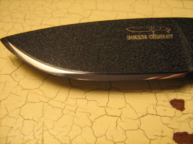

For example, this knife was once a V grind.
This was also V ground but this convex grind was done on benchstones to save the coating from being worn away. Though both convex one is a proper convex grind and the other is a convex bevel, big performance differences too.
Sure convex is easy but do most really know how to form them to a non convex blade? my guess is probably not because theirs not really any good information on how to do it and its constantly suggested to new sharpeners because its "simple". Truth is its not simple and requires previous knowledge of sharpening to even start to understand how and when to apply it to a knife. Their is less of a learning curve to V edges thus you learn them much faster, I started messing with convex edges 2 years ago and even with all the previous experience I have it still took me a good year before the light bulb finally came on.

My question is, (and just to be clear here, I'm not saying it's wrong, just looking for clarification), on the 2nd knife pictured, if the finish interfered with making a convex edge, why was it done?

Why was it done? Its a busse and as usual its thick, the convex was done to increase cutting performance and because it was the customer preference of grind styles (most of his blades are convex).
