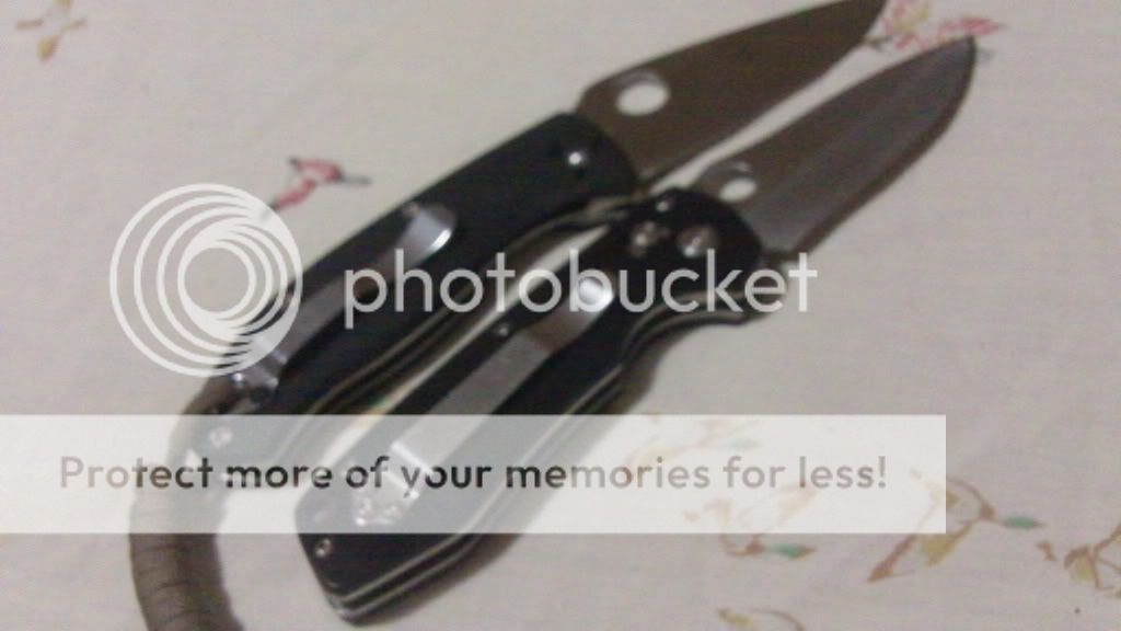

Even though there's alot of hatred towards Chinese brands like Sanrenmu,Enlan,Ganzo,Navy,M-Tech,etc. I still continue to purchase,use and test blades from these brands along with higher end blades and so far I've been very impressed with their quality and performance, today I'm going to review the Sanrenmu 962 which is a copy of the Benchmade Vex but with an Axis style lock,enjoy.
To start out I'd like to say the quality of this blade is superior to many others in it's price range and it offer's good fit and finish however it does have it's disadvantages which I'll discuss shortly,everybody knows about and/or owns a Spyderco Tenacious,Sanrenmu 710 or Benchmade Vex so here's some side by side shots of my 962's next to them for size comparison:
Overall it's a decent size for edc but I definitely prefer something shorter than a 3 3/8 inch long blade, along with this the handle is fairly thick (nearly 1/2 an inch) which makes it comfortable in hand but also bulky in pocket, at 4.3 ounces it's not the lightest blade for it's size but weight really isn't an issue for me,your opinion may differ, however they did actually skeletonize the very thick stainless steel liners to help reduce the weight which is nice to see at this price point and the micarta handles are a nice touch for the price.
The blade is made of 8Cr13MoV stainless steel which is similar to 440C or AUS8 so it will dull fairly quickly but will be easy enough to resharpen, however I feel the mid spine flat grind on the blade is inferior to a hollow grind or FFG for slicing, the organic drop point blade shape however just like the Benchmade Vex is excellent for various edc chores like food prep or opening boxes. The lock up is solid and has no blade play in any direction and the pivot screw is adjustable but requires a special tool to adjust (hopefully you can see from the pictures I forgot to take one of the pivot itselft) Overall I feel the 962 is a decent value but is beaten by the Spyderco Tenacious,Enlan EL-02 and Kershaw Skyline but for but for the money it's not bad.
