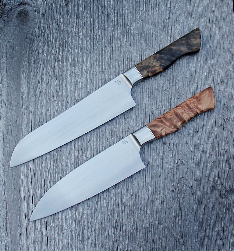

Santoku and Expirimental Funayuki in W2
May 5, 2010
622
170mm Santoku
Handforged W2 integral
Stabilized California Buckeye Burl
Bronze/G10 Spacers
Flat ground to .04 with a slight convex on the top third to minimize food stickage.
1 11/16" Heel height
A note about a 'funayuki'. When I made the lower knife I decided to put more of a tip on it than a santoku. It just seemed more useful that way. When Adam saw it he went and got an old Blackcod heading knife my Dad had brought back from japan and laid it next to it. Sure enough same profile. I looked it up and turns out it's usually single bevel (like Dad's) and originally intended for fisherman. How innovative of me to come up with something that's been used for centuries!

This is kinda exciting to me that a whisper thin edge will hold up that well without chipping at a much higher hardness than you can swing with hunting knife geometry. Apparently it can flex much easier at that thickness. As you might have noticed I'm finding chef knife creation thrilling.

I hope you keep at it with the kitchen knives.
You are making some beauties.
Congrats with the performance test.
beautiful knives Haley. the knife your dad brought looks like a Deba. Is it really thick at the spine?
Very Very Nice. I have played with some really thin W2. The edge wrinkled slightly so I kept it for myself to test. Used it in the kitchen to cut veggies with and it is holding up incredibly well. Don't even notice the wrinkle. Slices tomatoes like a hot knife........
Haley, Your kitchen knives are inspiring.

I like the bottom one (funayuki) the most.
GREAT handles on both.
