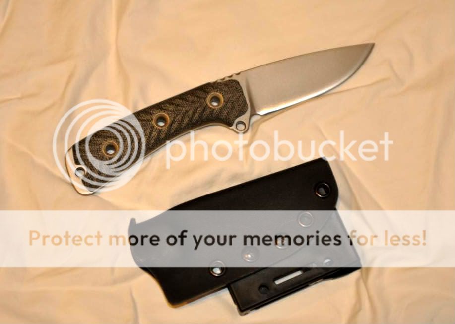

I am interested in buying my first Busse, specifically the SAR-3. It is the perfect size for what I want it for. The problem I am having (besides finding one to buy) is that I have not found any glowing reviews on it yet. Most seem to like the knife OK but are not impressed with its sharpening potential.
I am used to by Bark River knives that come extremely sharp from the factory and can duplicate that at home. Will I be able to do that with the SAR-3?? or is there some property of INFI steel that prevents that.

My Sar-3's all came factory sharp, however the angle at the edge is very steep to promote strength. BRKT uses around 10-15 degrees at the edge, where a Sar will be more like 30-50. As long as you can strop accordingly, it's no problem keeping INFI razor sharp. The biggest problems and complants seem to come from folks who have trouble sharpening. Sharpmaker won't cut it here;)

The SAR3 has a convex edge not a V edge. The Sharpmaker would work eventually after you re-profile the hell out of it.
If the sharpmaker is your tool for sharpening I would recommend reprofiling to a V edge so you can touch up on your sharpmaker. Although as stated above reprofiling on the sharpmaker may take some time without the diamond rods.

I sharpened most my infi on sandpaper to convex the edge on a soft backing. Then follow up with a strop.

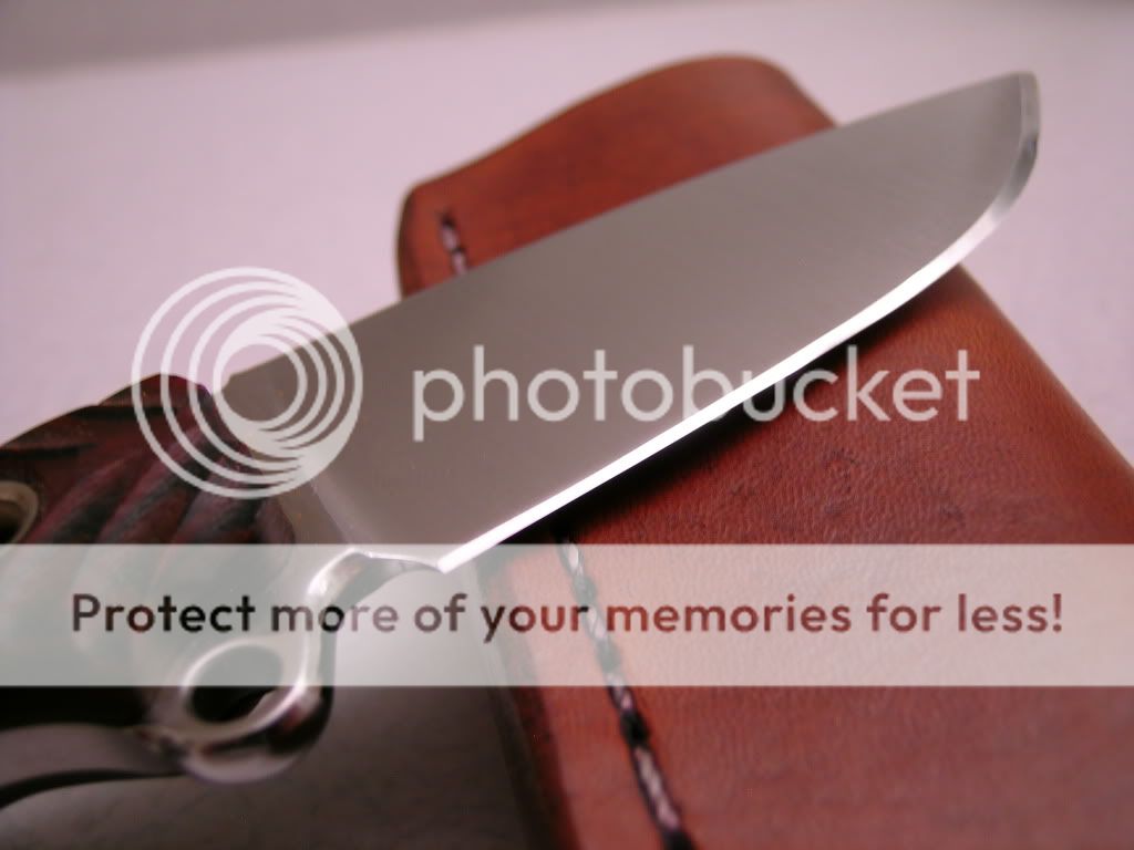

I just read in this thread that the sar3 are convex ground, but mine does not appear to be convex. I have a BRK Bravo 1 thats convex ground and several knives that are V ground, and my sar3 appears to be the latter. I'm a little lost, could someone clarify this point for me? I was under the impression that convex ground knives don't have a second grind line near the edge of the knife, rather they have only one grind all the way to the edge. Am I missing something? Thanks for info!
The next little gripe I have about my sar3 is that the grind appears to be significantly uneven. The tip being much thicker than the belly of the blade. Do my eyes deceive me? Is this intentional to provide additional strength to the tip? Or do I send mine back in for a sharpening/regrinding?

My SAR 3 SE came pretty dull.. I was a bit surprised that Busse let something like this leave the shop. I have two other Busses which came with a perfect edge, but the SAR 3 was disappointing. What I read in other posts that problem has now been solved for the new knifes, thanks to Jerry who listens to his customers.. but still.. didn't make my SAR 3 sharp ;o)
So I took my Edge Pro and reprofiled it to an 18 degree V-edge and polished it up to the 3000 grit tape and finished it off with the ceramic stick.. WWWOOOWWW!! I love that knive now!! It is by far the sharpest knife I own!! Difficult to describe.. all my knives are hair popping sharp... but this just even pops them easier, cleaner, perfectly!! Let's say it like this.. other knives pop hair like a very sharp knife.. but this one now pops hair like a true razor..
I love a good convex edge on a larger hard use knive like my FBM (which came with the most beautiful and sharp convex edge I could imagine!!) but on a smaller knive like my SAR 3 I prefer a razor sharp V edge as I don't use it for anything else than cutting and am not afraid of rolling/denting the edge.
