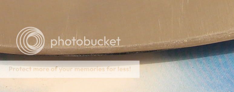

I maintain a convex edge with stones. Just make sure to grind down the back bevel (the blade just behind the edge) with each sharpening.

Do you have a close up picture of how a convex edge looks that is maintained with stones?

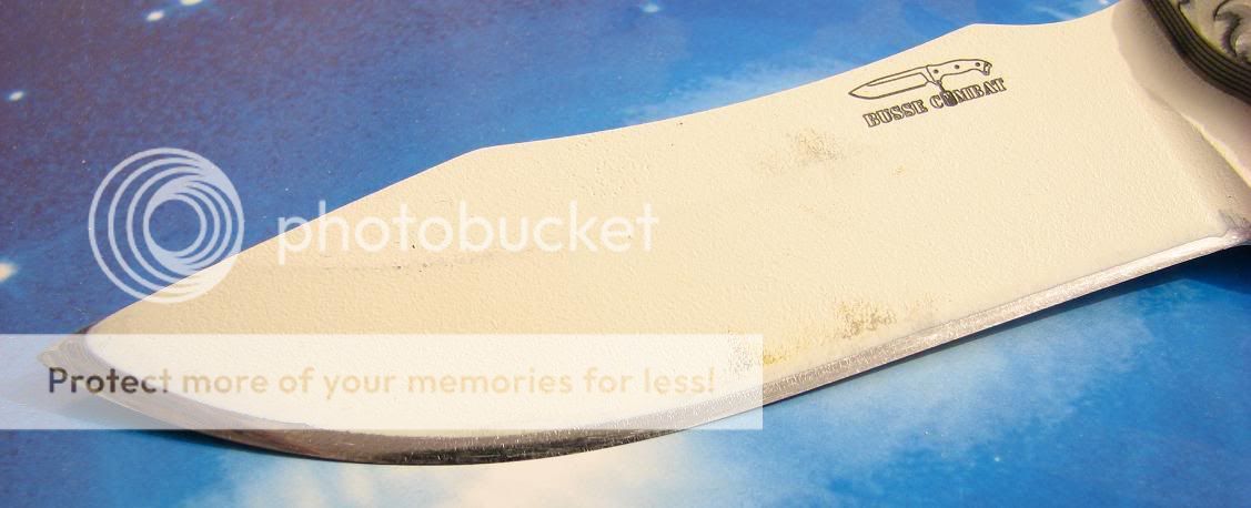

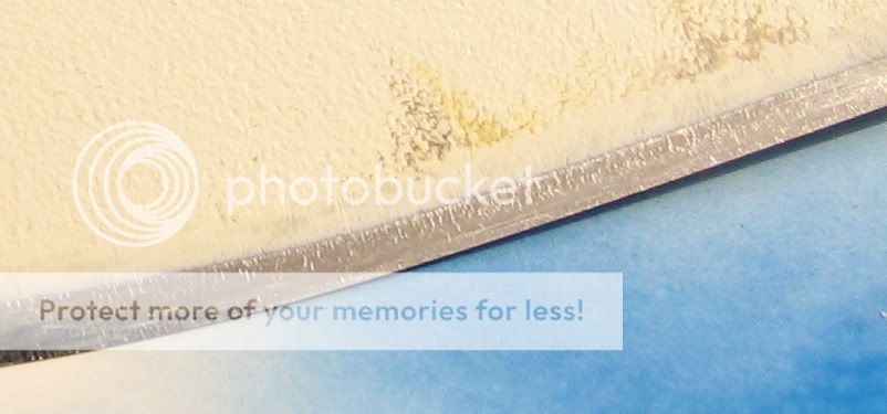

First off is the Tank Buster, which is probably most related to the topic at hand.
It did take a few hours on a rough stone to shape the edge, sharpened to around 15 degrees per side on the straight and 20-25 per side near the tip.

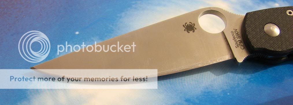

The S90V Military is still pretty close to stock angles (15 per side), no re-profiling here, but it is convexing nicely over time.

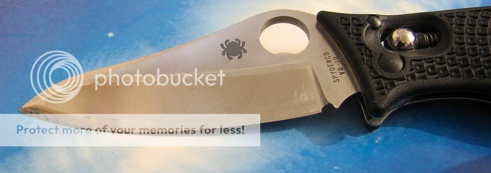

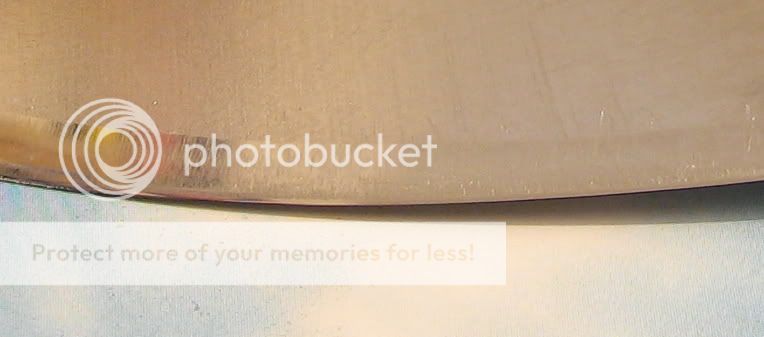

This D'Allara Drop Point was sharpened nearly flat with the primary bevel. The final edge angle is around 10 degrees per side, with virtually no steel behind it.
