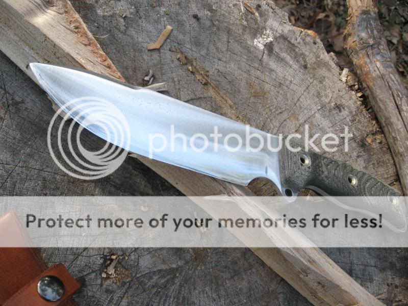

Here is one of Ban's most recent. Hopefully he won't mind my reposting this here for your viewing pleasure.
Here is a Black Linen Sarsquatch for your viewing pleasure :thumbup: Enjoy! as I am sure BaconSlinger will probably enjoy her more ;)
Thanks guys! Certainly saw that thread...and the other for the camp knife...all these folks posting pics and driving the need to buy!
