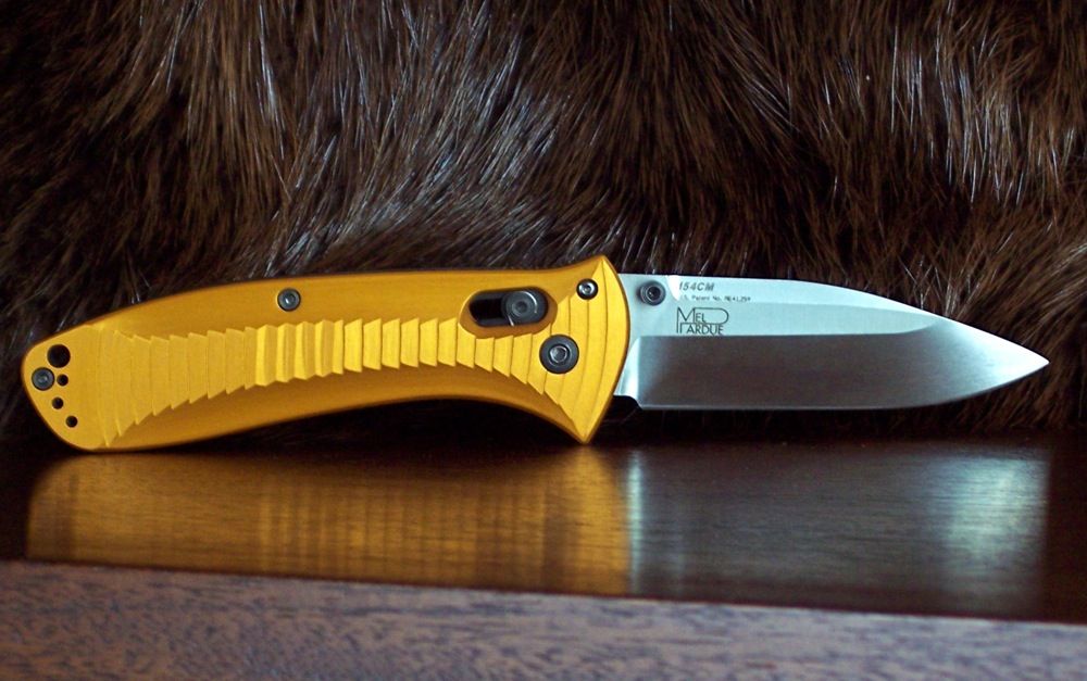

One question: how did you keep the upper edge so crisp from the sanded satin area to the BK1 coating? Masking tape?

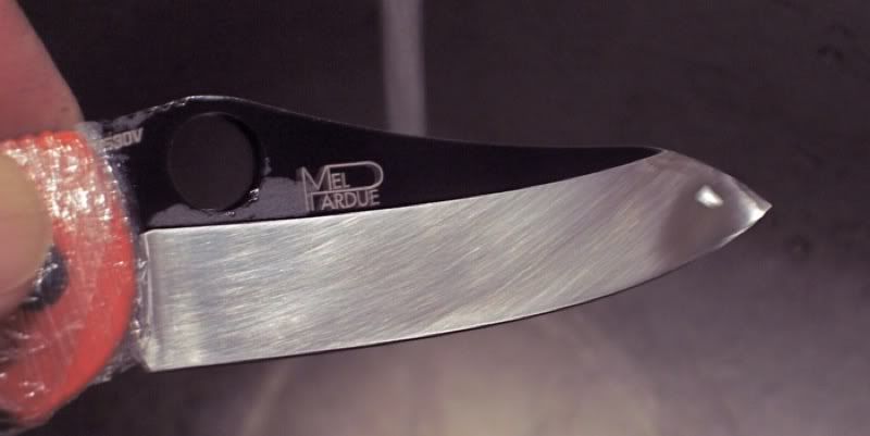

The little nick on the spine was there when I bot the knife:
I'm going to do this in stages as I'm not willing to risk organizing e'thing and then having it disappear, as it did yest'y.
In answer to the above question no, no tape. Just careful sanding, and that's the whole point. Crisp edges are the bugger, in this kind of work. You have 2 intersecting planes here (actually the main grind plane has a mild curve as it approached the tip, pls visualize) and you need to follow them.

On second thought not that expansive as this is after all a thread about satin finishing, but here's work that will help visualizing planes, bending planes, differential sanding pressures and the like. Here's one of my knives:

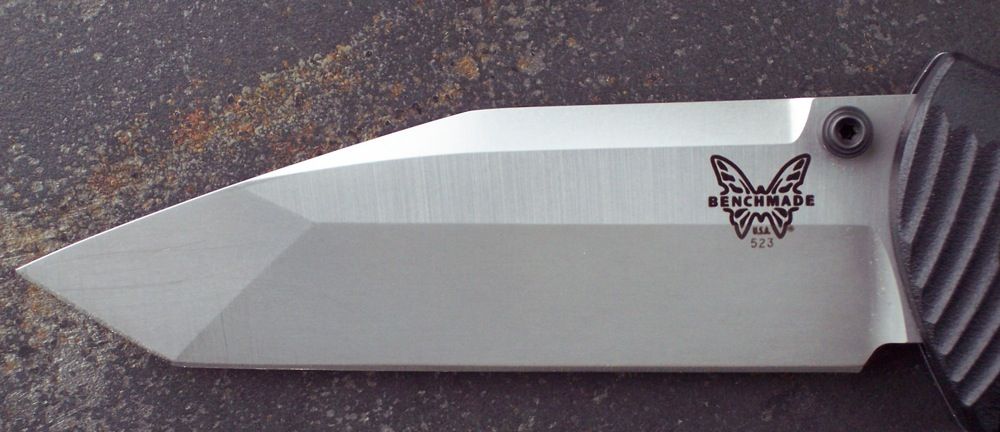

BM 523 tanto, but not anymore. Here's the work that was done (never to my complete satisfaction):
One side a little cleaner than the other, huh. No excuse for that. They should both be clean.
The orange one finished to either 1000 or 1500 (forget) as I wanted to retain some sparkle, which slowly fades as you go higher and higher. 523 finished to 3000, as I gen'y do.

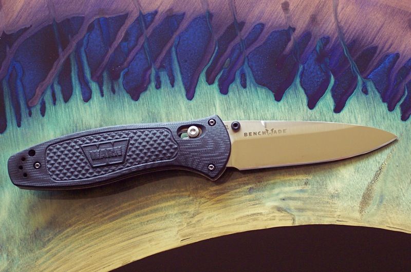

Tanto conversion to a spearpoint is fun work for me. My first was a 583-1 Warn tanto, now one of my favorite knives. Liners also skeletonized to compensate for weight loss up front it's now light, and balances perfectly, w/ just enuf weight-forward feel (assist also removed):
