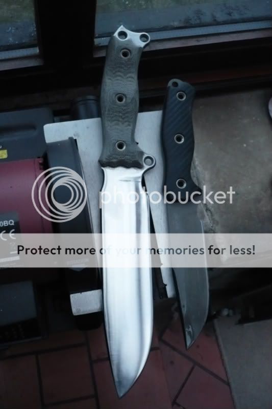

I have just done a Sage RMD and Sage NMSFNO today .... here are a few pics ...
The NMSFNO had a really tough coating on it and took about 3 applications of stripper to move it ....under this there was some light rusting ... however giving it a ghetto satin finish using a mix of belts solved that and satin Infi is very rust resistant ....
The RMD stripped much easier but under the paint is a powdered coating which I oil and then leave it to soak in .... then I can remove it on the blade with a sander without the dust clouding badly in the air .... the oil keeps it attached to the sander pad .... useful when it is freezing and you need to work indoors ....
For me though I like clear satin finishes on my small knives for food prep ... the powdered coating will last a good while though if you wanted to leave it on but then again there would be little point in stripping the knife if that was what I wanted ... however the powder coating lasts well on the handle and the lack of glare when sheathed is ideal for me ....
