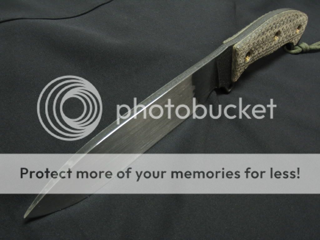

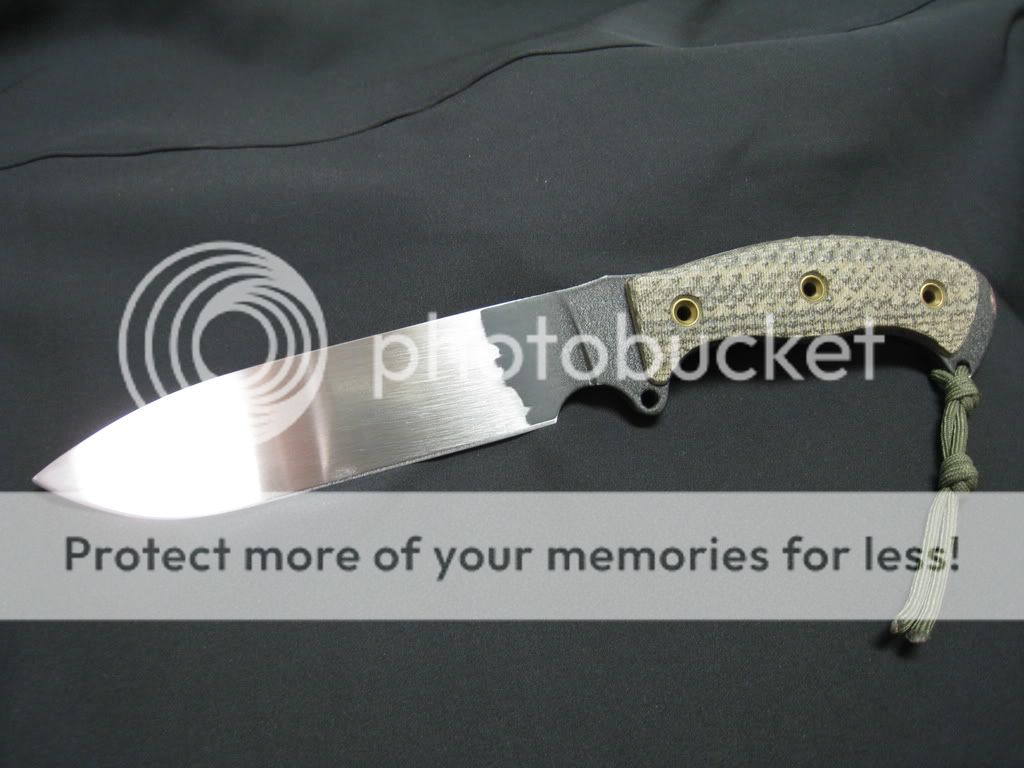

Right now i'm in the process of applying a satin finish on my ergo....I am leaving the coating on the spine and upper tang/handle. I think it has a cool look...
Ya i dont think its even possible to get to 900 degrees by hand...:D
ya i think i will be fine to. i was just wondering :)
PS: the lowest i went i grits (no not the food... :D) was 240... so i dont think i removed to much mettle (:D;))
