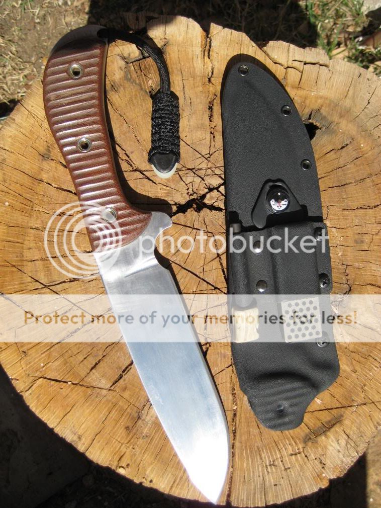

I've read most of the threads out there on satinizing, but I'm still not having much success, so maybe you guys can help out. I've been working on a Badger for about a month and a half now. I've tried hand sanding, wet-sanding, dremel sanding, belt-sanding and abrasive wheels on my drill. I've used 100 grit, emory cloth, and 220, 320, 400, 600, all the way up to 1000 wet/dry. I'm still not getting to where the INFI is smooth. Some parts--mostly the area of the blade that the belt sander can get to, have reached smooth steel. But particularly that area in the middle of the blade as it swoops down--that area that's hard to get with the BS because the BS tends to hit the flats first, that part is not that smooth yet.
What are some tips on removing all the decarb and other stuff to get down to that smooth layer on every part of the blade?

It's not so much dimples, it's more a slightly darker color than the smooth steel, and there are striations on the blade perpendicular to the edge.

The durability sucks... buy 2, but they worked pretty well on the dimples in this Chopweiler. (pic before using the 3m wheel to smooth it out).
That sandpaper wheel is a good idea. Wish there were better sanding attachments for the Dremel than those little brown sanding drums--they suck, and are uneven. In any case, I've been doing the best I can with my limited experience and tools. Those 3M wheels for the cordless drill helped alot, as did the sanding discs for the orbital (got that figured out). I think the perfect tool would be something like those 3M wheels, but more abrasive, and smaller. It would help doing fine work, like getting close to the handle slab, and working within grind lines.
