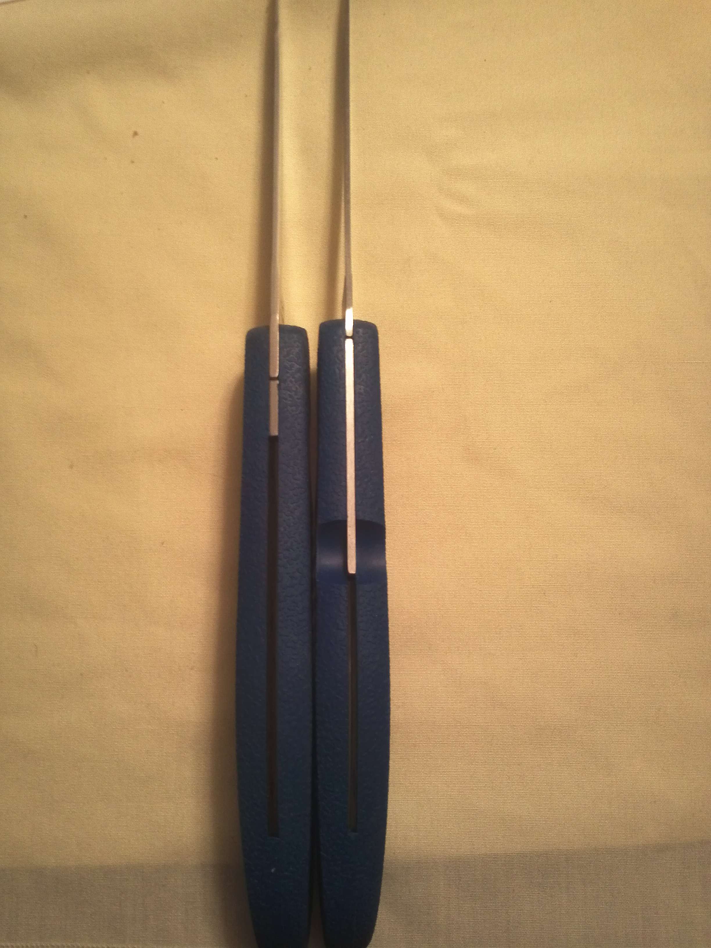

Here are a few pictures of both the first edition (1988) and the later edition (1990)
here is the two side by side, the Sawby locking system on the left. The Sawby, you have to push the lock in and fold the blade back towards yourself to close it.

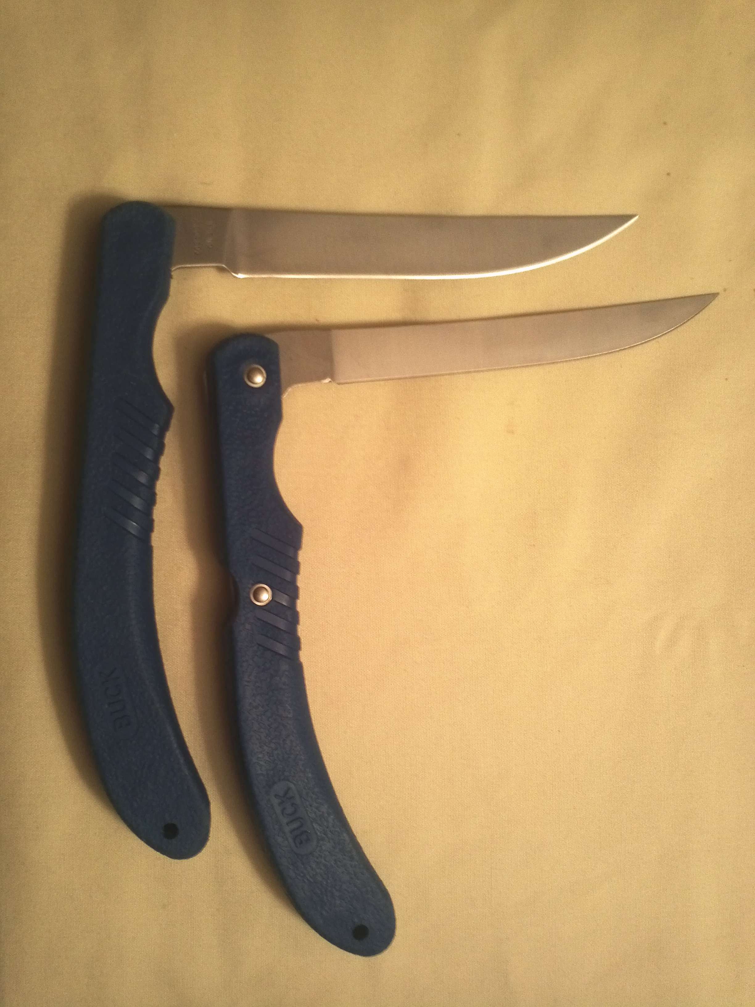

Both knives side by side, the newer of the two has rivets to hold the new locking system in place.

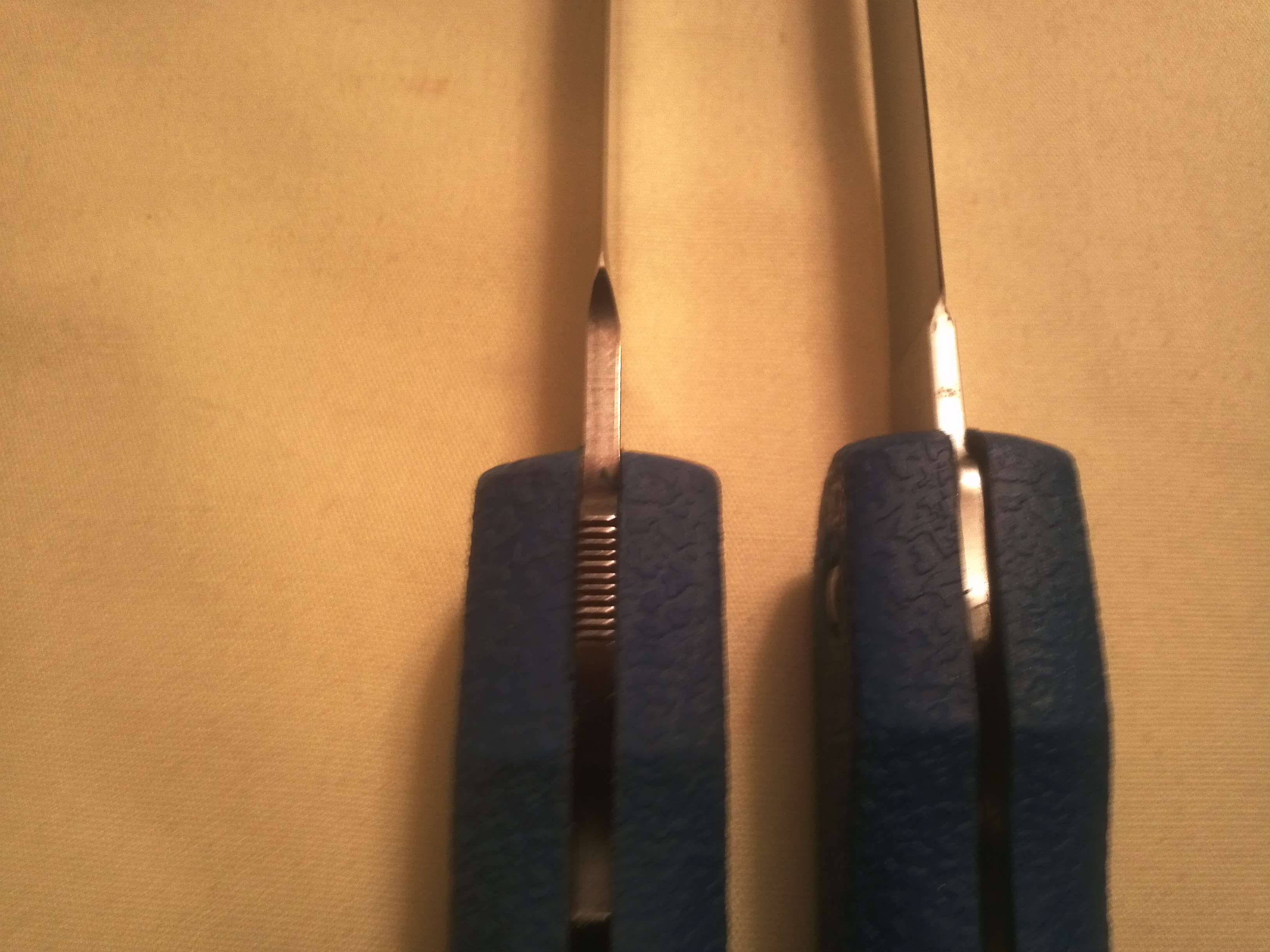

The spine of both knives, showing the body lock of the newer locking system.

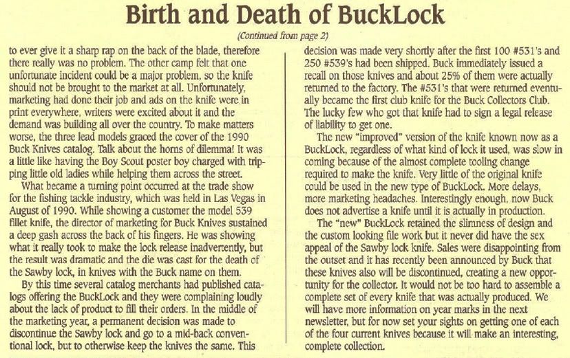

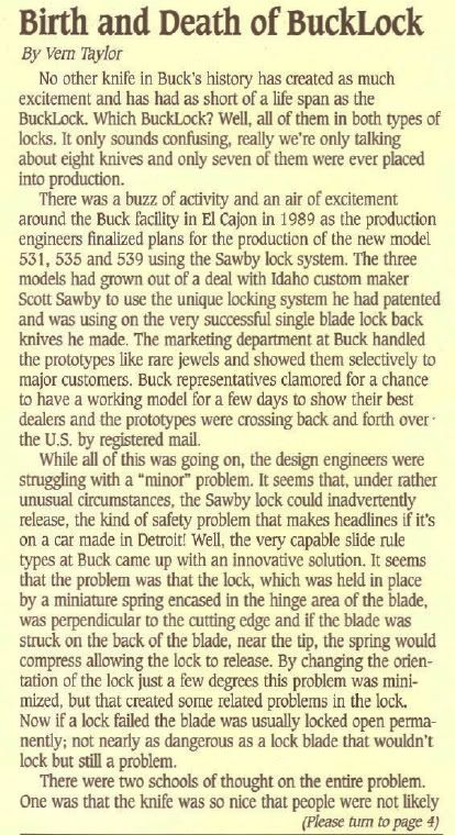

The "Sawby" locking system was granted a patent to Scott Sawby in 1986. Shortly thereafter, he teamed with Buck to create the first knife with this locking system, the 531 Bucklock-1 which appeared in the 1988 catalog along with the two blade Model 535 Bucklock-2. About 2,000 531's and several hundred 535's were produced. Shortly thereafter, it was discovered that the locking mechanism failed to hold the blade in a locked position if excessive pressure was applied against the back of the blade (the infamous "wack" test). That, along with Buck's concern for potential liability about a lock release that placed one's fingers under the blade (which may have resulted from the incident about the cut tumb of the important person that you reference), resulted in cancellation of the model line and a recall of the knives that had already been issued. (However, as we all know, a great many of those klnives survived that recall). Apparently, the locking system failure at the time was the result of the bushing ball lock being too small for the size of the 531. I believe that Scott Sawby is still active in the knife world today.

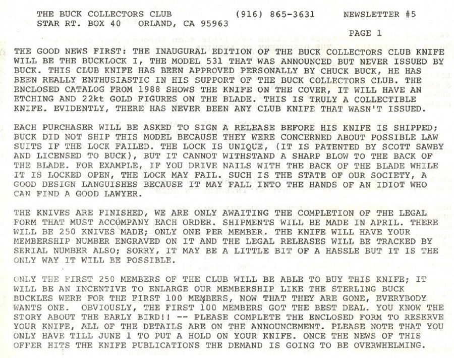

I bought a Bucklock 1 about a two and a half years ago and paid $245.70 for it. New in the box with all the paperwork and brown leather sheath. I also have one of them that was used as the first BCCI Members knife (1 of 250). I also have the Sawby 535 and when I locate where I have them stored, I may be able to provide the amount I paid for those also.
It's interesting that the newsletter says that the Sawby 531 was never issued. There were some that made it out of the factory, as I have one of them.

Thanks, Plumber for the additional info on this model. Joe H. gave a wrap up on this model at the factory in 2008. Mr. Sawby corrected his lock back in 88 and reissued in 89. He puts out a very nice model today. DM
I don't think it is accurate that the 531 was never released. I have read several articles (can't find any of them now) that state that when Vern Taylor was organizing BCCI, and it was decided that the 531 would be the first club knife, that he searched retail establishments far and wide to secure a sufficient number of 531's for that club knife.
Yes, thats correct. The club was organized by Vern in 88 and that model was the first club knife offered in 89. Several collectors here have them. DM

Maybe you'all didn't read this but it did say that the first 100 531s and 200 539 had been shipped to retailers. Buck had to do a recall to try to get them back. Only a quarter of them came back. That means that they were released and at least 75 remained in public hands. I know 75 knives aren't many but to say they were never released is misleading and wrong...
OK maybe it's me that can't read, I thought the argument was that the knife was never released. My mistake.
