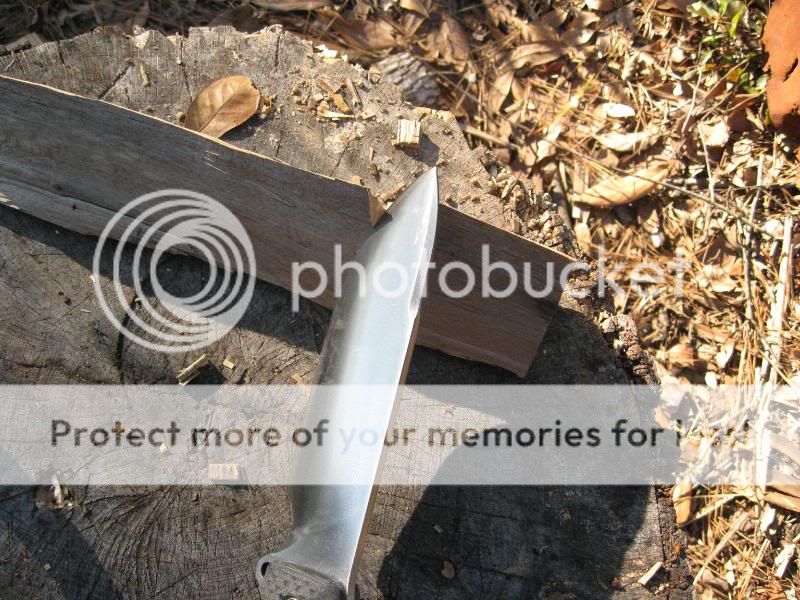

I had let my Busse Sarsquatch CE rust. I buffed off the rust with Scotchbrite, but that funky dark "decarb" layer just had to go. So today I sanded it with an 80 micron belt. Not a true satin finish (after all, it is a competition model), but brighter and hopefully, less prone to rust.
Here it is along side my new SOD LE for comparison.
It still chops as well as it ever did, of course.
Turned out sweet and looks to be scary sharp, very nice.

Thanks. I'm happy with it. My Scotchbrite wheels just couldn't cut all that dark decarb layer, but a bit of sanding did the trick.

i feel like a moron for asking this question but why is the Decarb layer put on the knife if removing it is standard practice?
and again.....i am sorry for the NEWBish question,:o
From what I read on this forum, a layer of decarbonized steel forms on the blade surface during the heat treating process. It is not something they "put" on the blade, it is just a byproduct of the heat treating process. At least that is my limited understanding of it.
Jerry couldn't have said it better!:thumbup:
Thanks, Solstice. I was hoping I got it right. In any case, none of my more polished INFI blades have had the rust problems I had with the CE model, so maybe this will help.
So is the 'decarb' actually iron oxides? Because 'decarb' sounds like carbon involved, and other than the carbon attracting water vapor molecules and causing rust carbon should'nt be a problem on the steel surface. Would'nt it make a 'coating' of sorts, and prevent rusting? I hear it's a B''ch to get off the surface, so that sure sounds durable to me.
I barely survived chemistry class. But if I remember correctly, rust is caused by iron being oxidized. If the surface layer carbon is burnt off during the heat treat, maybe it is more like iron left behind on the surface. One thing I can say for sure is that the "decarb" layer rusts very easily and INFI does not.
By jove, I think he's got it!
The decarb layer is normally removed in the process of finishing the knife up and making it more pretty. Since these are meant to be left ugly beaters, they did not spend the extra time and expense of cleaning the blades and spiffing them up.
