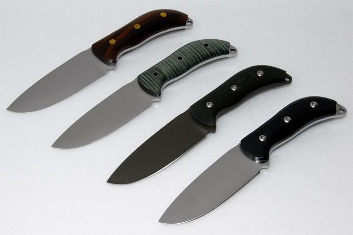

Also, some comments on the videos, as I shot them at home in my kitchen with my digital camera, while testing one of my knives. The Pasvikka is about 3.5 to 3.75 mm at the spine, the blade thicknes right above the edge is indeed 0.05 to 0.06 mm. If you look at the way I chopped into the bone you will probably notice that I always tilted the blade to remove it from the bone because I tried to provoke chipping of the edge. However, the blade showed no signs of chipping at all.
BTW, here are some other Pasvikka, just contact me or Jürgen Schanz, if you like them.
I also showed some of the knives already here (BF Gallery).
