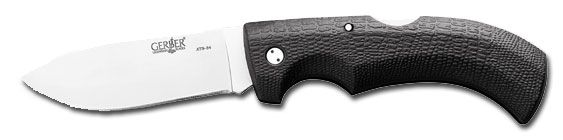

I like this knife for what you are looking for. It's a drop point Gerber Gator with rubber handles. I don't own this knife but have handled it and it has an extremely comfortable grip. I think between the grippy rubber handles and the index groove it should be very secure in the hand even when bloody. The absolute only reason I do not yet own this knife is that I am partial to knives with clips and because this knife handle is of the rounded sort (like you wanted), it would be a little too bulky in the pocket and therefore comes sans clip. Which brings me to the other part of your question. The handle slabs are generally flat so that it doesn't leave a large print in your pocket (on folders anyway). The slim profile draws less attention and is less likely to form rather unseemly bulges in your pockets.

Zenghost, I plan to use the knife only to gut, skin and dismember big game animals. It will be carried in a special pouch in my backpack so I would plan on removing a clip if the knife came with one anyway. I looked at the Gerber Gator and liked it except it was bigger than I wanted. The Gerber Gator Mate was smaller than I wanted. It is being hard to find exactly the right knife. Rufous.
