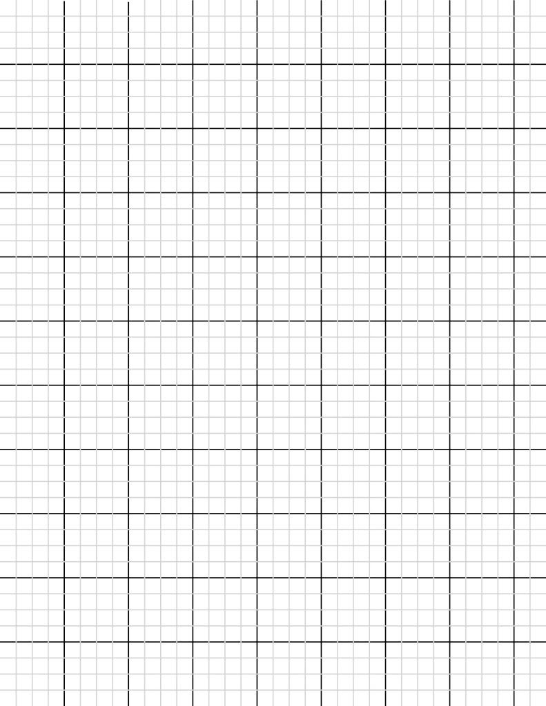

I have printed out a scale grid on a standard 8.5x11" paper. Put the knife on it, took a picture. Repeated the process for several knives. Then I edited some pictures together for size comparison.
With this method, it doesn't really matter if picture size or resolution is different. It is still very easy to put two together. All what really counts is that shots are taken from straight up.

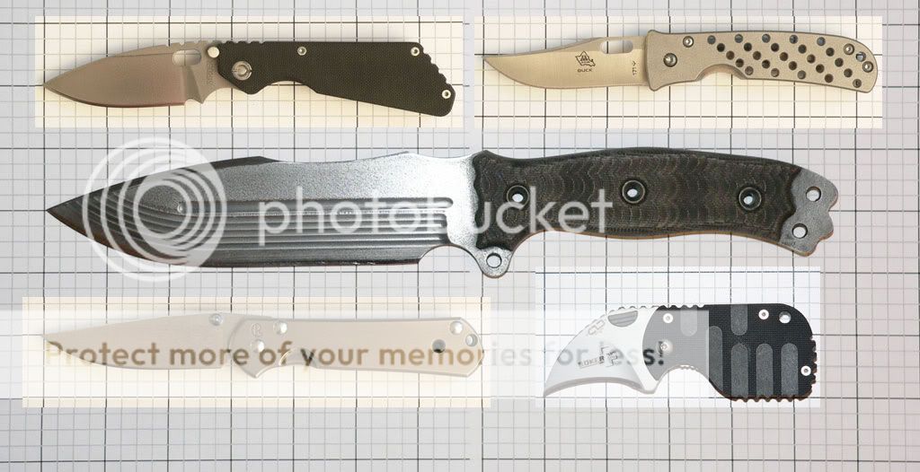

Here is one made from five pics. Gives you an idea of Busse Hellrazor next to Small Sebenza, Strider PT, Buck Waimea and Boker Subclaw

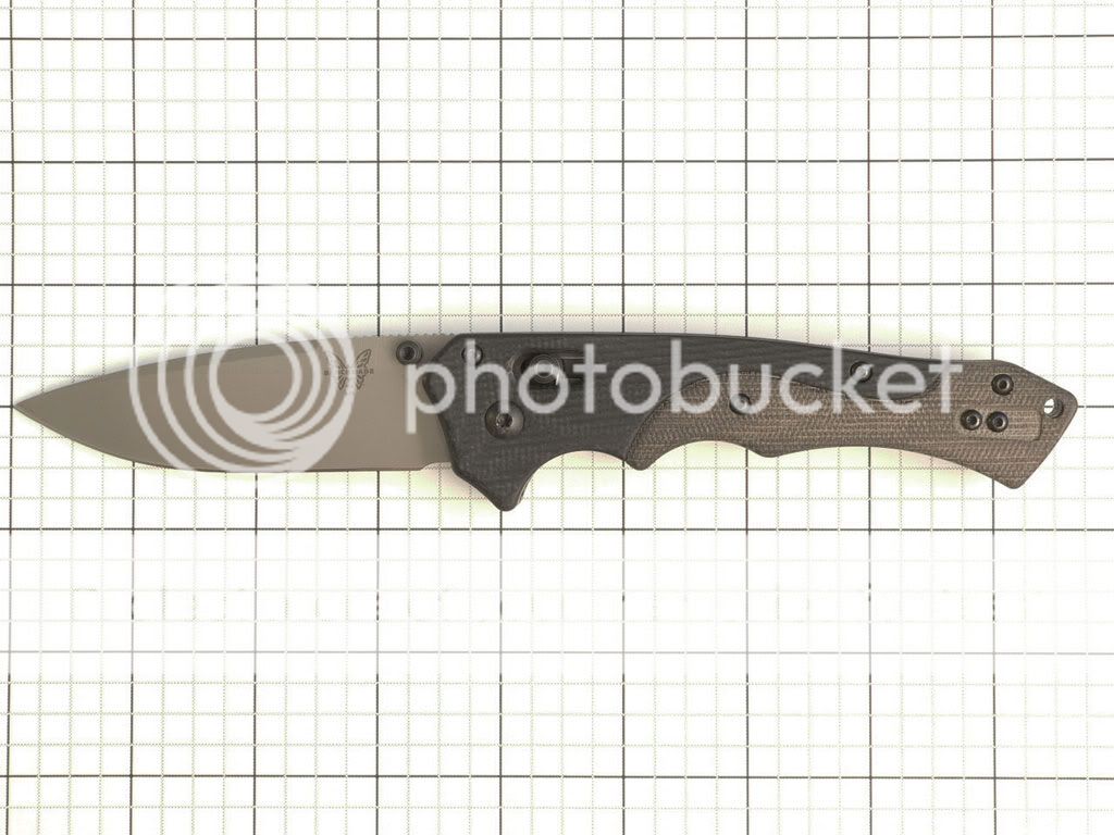

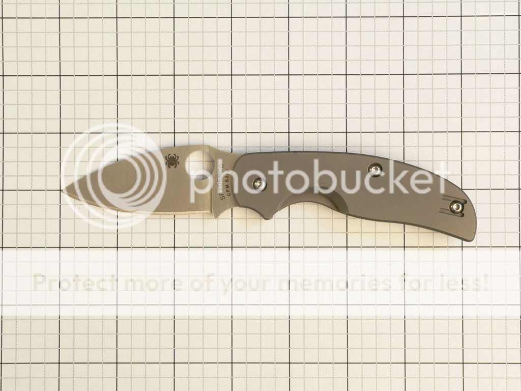

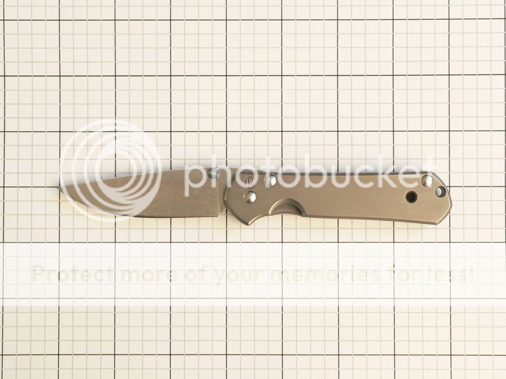

This one is put together from three different pictures from above. Color tone was adjusted:

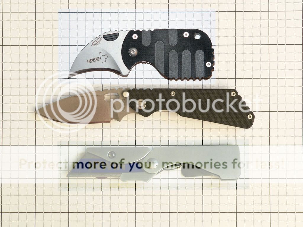

Here is an example why quality and size doesn't matter too much.
First picture taken from tripod, no flash
Second picture taken with no setup at all, with flash
Notice a different magnification.
Third picture was screwed up on purpose. Bad quality, zoomed in.
When put together with adjusted brightness on the third picture anyone can get an idea about the size of Strider PT next to Boker Subclaw and Gerber EAB
