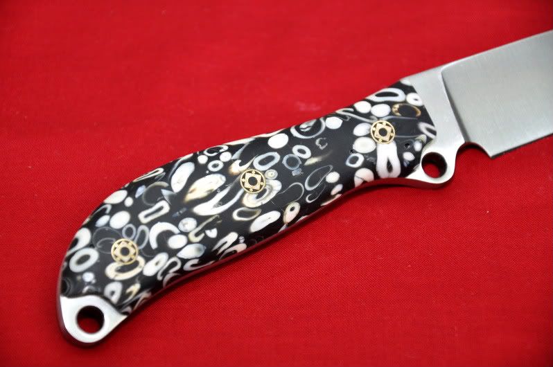

The only thing I've seen from busse that might be considered "blacker" may be the pure epoxy/acrylic polymer/whatever they use found in roenman's alligator tooth custom. I think that black paper has a better 'reflective blackness', where the pure epoxy has a deeper semi-translucent blackness.
http://www.bladeforums.com/forums/s...-the-Fence-About-This-One?highlight=alligator

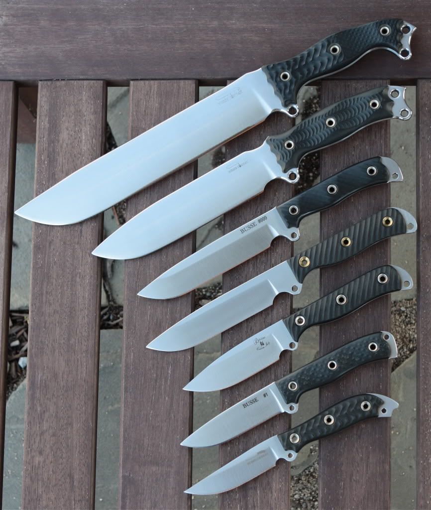

The knives in this picture range in age from the first black paper Busse's to the most recent and I can tell you that every single one of them was black as can be. Not sure how they look now though since most of them are gone. :foot:

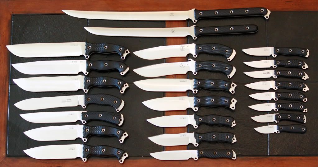

Still have these ones though and they are nice and black.;) (the lighting is playing tricks but they really are all black)
