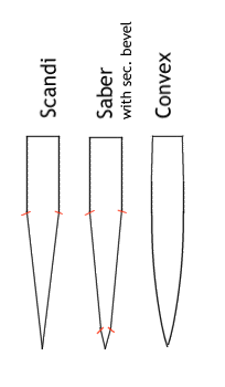

I have do some research but cant quite find what im looking for. Is the scandi grind some what similar to a convex edge where there is no secondary bevel. Does it just grid down to from an edge like a convex edge? Any where to see a comparision picture. The reason is im looking to by a bushcraft knife from roger linger and saw me made scandi grind blades. Also how easy is it to sharpen in the field (generally, not type of steel). Can anyone help im confused.
The so called scandi or zero grind has no secondary bevel, but it is flat instead of convex. Actually it's saber ground, since the bevel doesn't extend the whole width of the blade. Often a reeeally tiny secondary bevel can be observed, likely from removing a burr.
Sharpening is easy if somewhat laborious. You use the single bevel as a guide, laying it flat on a stone and then just sharpen as you would any knife. If your zero ground blade has gotten really dull, use aggressive/rougher grit abrasives first. For touch ups, using a steeper angle and a couple strokes on a fine stone, and so creating the tiniest secondary bevel (microbevel, as some say), doesn't really take away from the geometry
[edit] a cross-section:
angles marked with red

Okay, for what i understand, you lay the primary graind competetly flat on a stone and sharpen that way. Thanks for the pic, that really clearifys think. next question, can the blade have some sort of coating, epoxy or hot blued, is it possiable.
